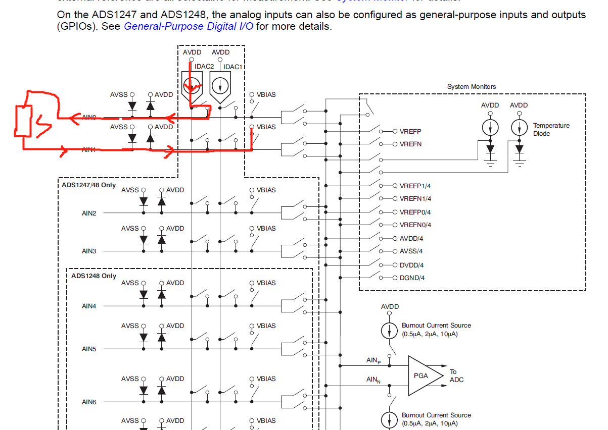

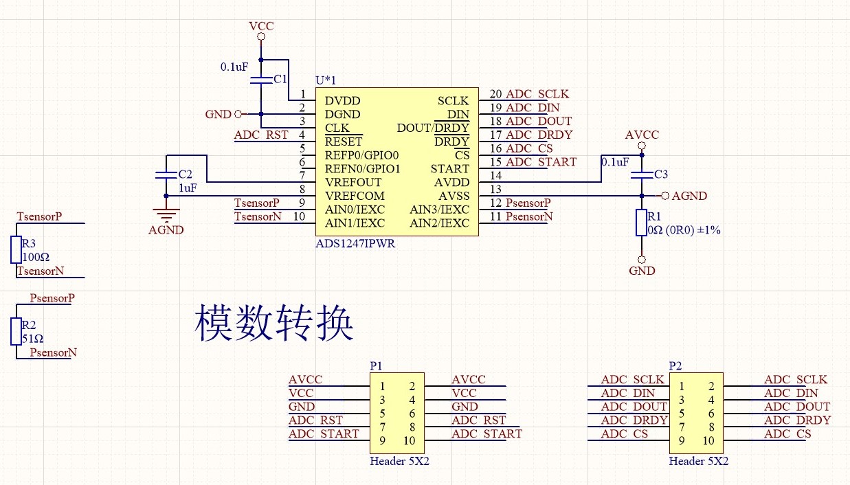

This is my major design and i want to measure the resistance sensor variable with a constant-current source.
fig1 show my hardware design
fig2 show my idea

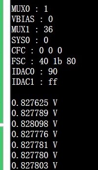

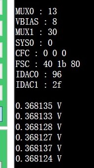

i set the MUXCAL bit of the MUX1 register and insured device was working in Analog supply monitor. The Conversion result was right.

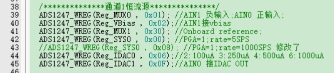

But i set the device with my idea and the conversion result was no right.
fig1 schdoc
fig2 myidea
Debug1
output format
debug1 result
Debug2
debug2 result

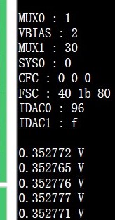

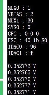

Debug3
debug3 result
  • The Right result of Conversion in debug2 should is 0.1V(1mA×100Ω) but the result is 0.352V .
    And The Right result of Conversion in debug3 should is 0.051V(1mA×51Ω) but the result is 0.368V
    I sure  the voltage between AIN0 and AIN1 is 0.1V and AIN2 and AIN3 is 0.051V with the ammeter of Fluke
  • Hi Lance,
    Welcome to the E2E forum!  There are a couple of very important considerations.  The first is the current path from the IDAC must flow to the AVSS (AGND).  So the current path through your sensor must complete a path to AGND.  The second consideration is the analog input range.  Due to the input restriction for the PGA, the sensor to be measured cannot be directly connected to AGND.  This would require a value of resistance in series with the sensor that will bias the input to the correct input range.  The input range is discussed on page 27 of the ADS1247 datasheet in section 9.3.2.1.  The third consideration is to make sure that the total voltage drop across the sensor and the bias resistor does not become so large that the IDAC compliance voltage is exceeded (see Figures 41 and 42 on page 19 of the datasheet).

  • Hi Lance,
    It would be helpful to know exactly what types of sensors you are wishing to use.  It appears that one sensor may be a 2-wire RTD (such as a PT100).  After reviewing the drawing again I see that you wanted to connect the temp sensor to the IDAC source and then to VBIAS.  This will be problematic for a couple of reasons.  One potential issue may be with compliance voltage when using the IDAC.  The second and bigger issue will be that the VBIAS is not meant to sink/source significant current.  The VBIAS is designed to bias sensors such as thermocouples.  If you attempt to drive a lot of current through the VBIAS switch you will see the error of the switch resistance in the measurement.
    As I did not initially notice that you were using the VBIAS, I mentioned directly connecting the sensor to a bias resistor.  The bias resistor could also be used as a reference resistor for making a ratiometric measurement.  In this case the resistor would be in series with the sensor.  I would suggest taking a look at A Basic Guide to RTD Measurements:

    Thanks for your instructions and i realize using Vbias is a error in my design. The character of sensor my used is similar to a 2-wire RTD, so following the example i understand now.
