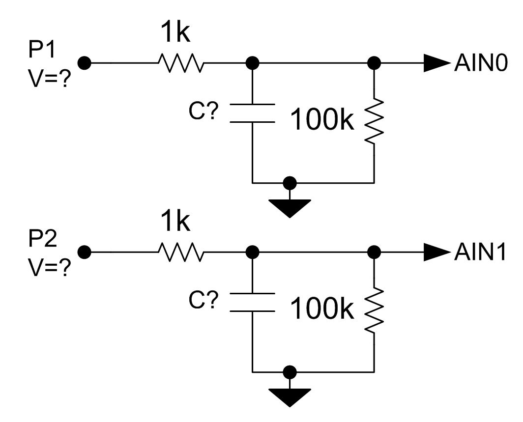

    Can you please clarify how you are applying a voltage to pins 1 and 2 and P1, and what those voltage levels are? Is 200 mV a differential voltage e.g. AIN0 - AIN1?, or is that single-ended referenced to AGND?
    Also, what is the ADC data rate, and what is the cap value on the input e.g. C12, C13, etc.
    This is how I am interpreting the input structure to the ADC and where you are tapping the input to the ADC. Let me know if this is incorrect, and if you can clarify the voltages and cap values as shown.
    -Bryan
  • Dear Sir,
    200 mV applied as a differential voltage between AIN0 - AIN1, through RC network similar to that you have drawn above.
    ADC data rate  :  30,000SPS (default)
    Cap value        :  0.1uf
    What is the absolute voltage at P1 and P2? The voltage between these points is 200 mV, but does P1 = 2.5 V and P2 = 2.3 V?
    -Bryan

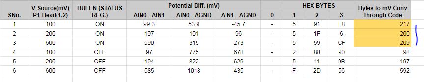

  • Dear Sir,
    I have made the following observation.
    Test Case / Note:
    1. Input analog voltage source is provided from calibrating device, which is powered by own battery so their is no common GND. between ADC board & Calibrator. AGND(* pin 2 ) of adc IC is connected to GND of the ADC board.
    2. Input Source is applied at P1-Header between pin 1 & 2. Due to series resistance their is some drop but that is fine.

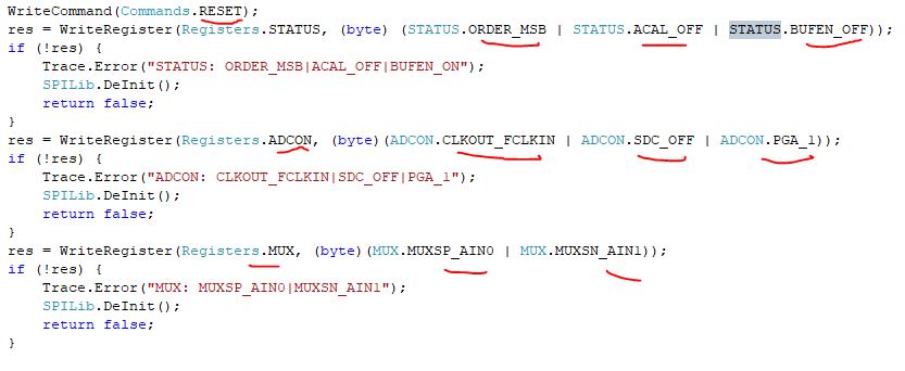

    Register Settings during initialization of ADC.
    Observations :Hex byte is as per readBuffer array.

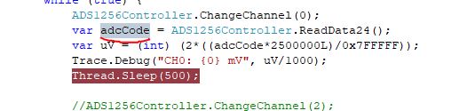

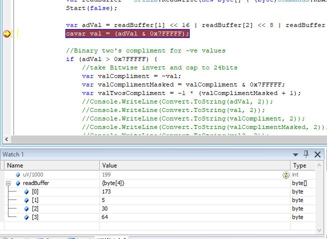

    Hex Byte conversion in the code. (*readBuffer Array)
    var adVal = readBuffer[1] << 16 | readBuffer[2] << 8 | readBuffer[3];
    Hex Bytes to uV / mV Conversion : adcCode will contain the return of HEX byte conversion .
    Sir, if BUFFEN of status register is OFF then we get everything fine. Kindly let us know what can cause such problem when it is Enabled.
    Harinder Singh

  • Hi Harinder,
    I am confused by the result shown in the table in your last reply. You had told me that for the 200mV measurement, P1/AIN0 was at 200 mV and P2/AIN1 was at 0 V (GND). So when you measure between AIN1 and AGND for example, the result should always be 0V, since both points are tied to the same potential. But you are showing >600mV in some cases - how is that possible?
    The table also shows that the differential measurement result is the same (and close to the expected value) whether the buffer is on or off. Are these results measured with the ADC or are you measuring them with a multimeter or other external tool? What do the hex bytes in the table correspond to? Three bytes would represent one 24-bit value, so it is not clear which voltage value in the table goes with which hex value.
    Please help explain the results you have posted.
    -Bryan

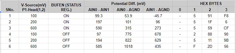

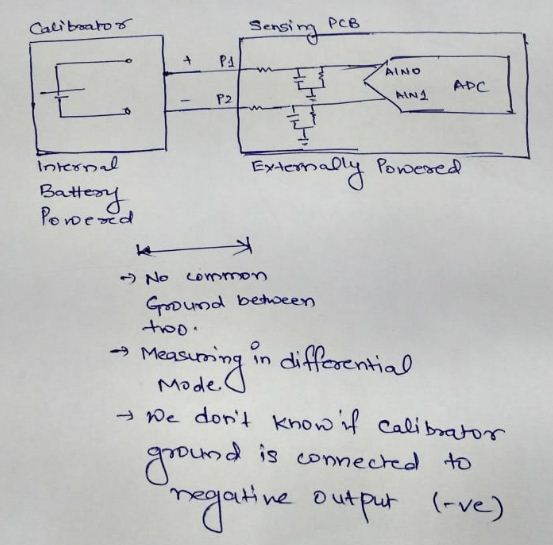

  • Dear Sir,
    This is the Basic Block Diagram of our Setup.
    Hex to byte Conversion Table : Sir, As you can see byte conversion is not correct for BUFEN enable.
    We are using mutimeter to measure the voltages.
    Harinder Singh
  • Hi Harinder,
    For the first three cases in your table, one of the inputs must be below ground in order to get the differential voltages shown between AIN0 and AIN1. You show this in the first row where AIN1 = -45.7mV relative to GND. I am guessing AIN1 is <0V in all three cases, though it is not shown in the table. Otherwise, for row 2 for example, you should be getting AIN0-AIN1 = 101mV - 96mV = 5mV.
    Please note that the ADS1256 cannot measure voltages below AGND when the buffer is enabled, though it can measure down to AVDD-0.1V when the buffer is disabled. Are you able to level shift AIN1 up a few hundred mV to make sure you are within the operating range of the ADC?
