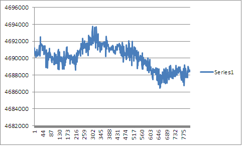

I have ADS1231REF Board, I'm Using it for Strain Gauge Sensing.
I'm Using TI GUI and also Tera Term to log data, While logging data there are many unreadable Garbage values.
Is there any solution for it/ why this is happening?
It is taking more time to filter data, is there any way to filter the data?
Collected from ADS1231REF
3/2/2020 1:34 PM
Speed=Slow Gain=128

  • Hi Supriya,
    Welcome to the E2E forum!  I looked at the data file sent, and I do not see any issues with the data other than noise/drift.  I imported the data file into Excel with the following result:
    Can you be more specific as to what you are referring to as 'many unreadable Garbage values'.  If you attempt to capture data as it is sent to the console terminal screen, you will see the values returned as ASCII characters representing hex values.  For example the decimal value of 4690561 would be transmitted as 479281 representing the hex value of the number.  Another example would be decimal 4690127 which would be transmitted as 4790CF.
    It is easier and more consistent to transmit the result as 6 ASCII characters of the hex value than it is to transmit the number as a decimal.  This places more work on the GUI instead of the much slower microcontroller.  If you are capturing the data from the terminal console as it is transmitted, then you would import the data into a program like Excel and then convert the hex value to decimal (HEX2DEC(hexnum)).
    As to the data file sent, as I said there is considerable noise and drift.  This could be due to the measurement not being truly ratiometric or noise pickup from cabling.
    Bob B
  • Hi Supriya,
    To be of further assistance, please send me the data showing precisely the 'Garbage values' you see.
    Bob B
  • 1000Cycle_Test_02.txtHi Bob,
    Thank you for response, I'll check on cabling.
    this the data for your reference, If I convert Hex data to decimal there are many errors.
    Kindly check and let me know the cause.
    Regard's
    Supriya
  • Hi Supriya,
    It is still not clear to me what the errors are that you see.  What would be helpful is specific information as to what input voltage was applied and what output code resulted.  And in your data set which lines in particular you find that are garbage.  What I do see in the data file you sent is an incredible amount of noise.  I believe the bulk of the noise is power line-cycle noise that is most likely being picked up by the cabling.  So at this point I think you have a much larger issue relative to noise than the ability to collect long term data.
    I do see error in the last three lines of the file.  If this is the garbage data that you are referring to I would agree that this data is incorrect.  This could be a USB driver issue or something related to the terminal capture itself.  I do have some concerns that the timing of the capture is inconsistent. The time stamp should be more consistent with the data appearing at close to 100 ms intervals.  At some point there could be a buffer overrun and the data are corrupted.
    If the board or input to the board are shocked by some ESD event (by moving the board or even touching the board) or a large EMI/RFI interference, there could be an issue as there is very little input filtering on the inputs. Replacing the 0 Ohm resistors (R23 and R24) at the ADS1231 inputs with something like 1k might add more protection. Also make sure that the power supply is stable.  The USB interface uses the USB 5V supply from the PC which differs from the supply for the ADS1231. To account for any voltage differences or variation a digital isolator is used with the UART communication from the micro. A TUSB3410 UART to USB interface device transmits the data from the micro to the PC.  So there are many pathways where the communication can be corrupted or delays causing a buffer to overflow.
    Just to be clear, the Scale mode using the ADS1231REF is meant to be run using the REF board alone and no connection to a PC. When using the USB connection for communication the Mode switch SW5 should be in the Analysis position and not Scale.  The ADS1231REF firmware uses an RTOS and although there is some communication available, the response and priorities are different.  If you are operating in Scale mode while collecting data this may be part of the problem.
    Another point to be clarified is the ADS1231REF is a demonstration and evaluation board and not designed or tested to collect long term data.
