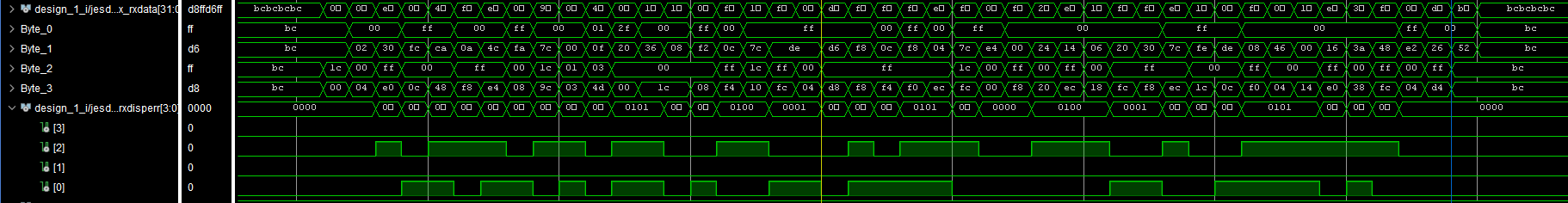

    We have performed a full RTL simulation of the problem using the ILA octets received by the ADC as a stimulus. If the data is encoded correctly, there are no errors reported by the FPGA:
    However, this is what we see during ILAS from the ADS54J66 (the ordering of the bytes is reversed in the screenshot):
    The disparity errors only occur in every other octet, every time, starting with the third octet of ILAS.
