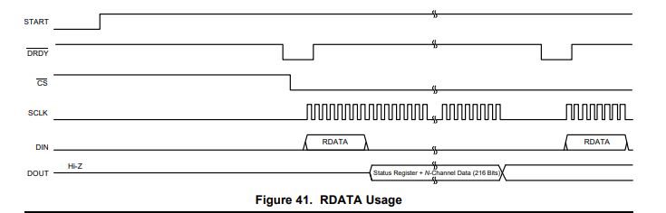

    I would like to ask more question about your answer No.2.
    According to the data sheet, if the Start pin is set to High and an RDATA command is sent, Satus and N-channel data will be read.
    As shown in the figure below, it can be read when the RDATA command is sent and Status + N-channel Data is read at the next SCLK.
    When operating in RDATA mode, it is good to recognize that Status and N-channel Data are read immediately after the RDATA command is sent (from the next SCLK) if the Start pin is high as shown below?
    Y.Ottey
  • Hello Y.Ottey,
    First, the START pin is used to start ADC conversions. After the conversion completes, then the data can be read. If you want the conversions to continue, then you can keep the START pin high. If you do not need the conversions to continue, then you can pull START low. After the /DRDY indicates the last conversion, you can still use RDATA to read the data from the device.
    When operating in RDATA mode (not in RDATAC mode), the RDATA command can be immediately followed by the read of the STATUS and ADC data with the clocking of SCLK.
    Did I give you the answer you needed? I'm not sure I understood what you asked in your question.
