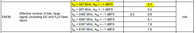

Will the ENOB spec on page 16 of the datasheet vary if the device is in dual mode?

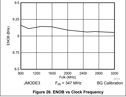

Hi Elisha,
Figure 26 on page 30 of the datasheet show the ENOB in Dual mode.
Neeraj
Figure 26 is showing ENOB vs sampling frequency with Fin = 347MHz. Where as Enob shown for Single channel with 347MHz is for fixed sampling frequency (3.2GHz). So if you compare the two, the ENOB for dual channel mode is 9.1 bits where as for single channel is 9bits respectively. Not a huge difference.
