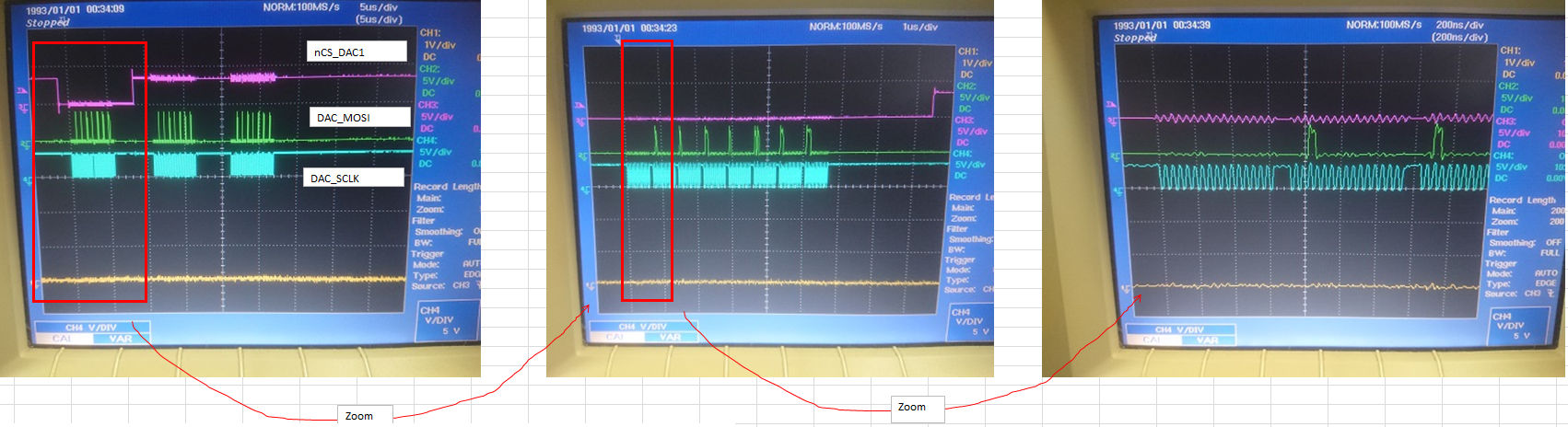

My customer plan to use DAC108S085.
The customer would like to output the updated register on all channels at same time. After that the customer will change the /CS to 1.
Could you tell me whether this use case is correct or not? I've attached the waveform that the customer took.
Yoshi
  • Hi Yoshi,
    This use case is not valid as there is a timing violation of SYNC (/CS) tSH (SYNC hold time after the 16th falling edge of SCLK) min is 3ns and max is (1/Fclk - 3) ns.

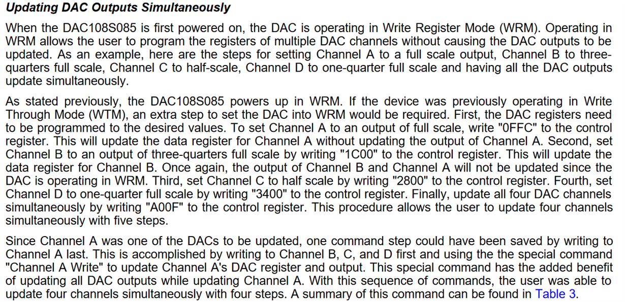

    One way to update all DAC simultaneously is using WRM mode. In WRM mode the registers of individual DAC can be written without updating output values.
    After writing into all registers change the device mode into WTM to update all DAC's output simultaneously.
    For more details about entering into WRM and WTM mode please see datasheet page no :17.
    Revert back to me if you need more clarifications.
    AK
  • Hi AK,
    Thanks for your answer.

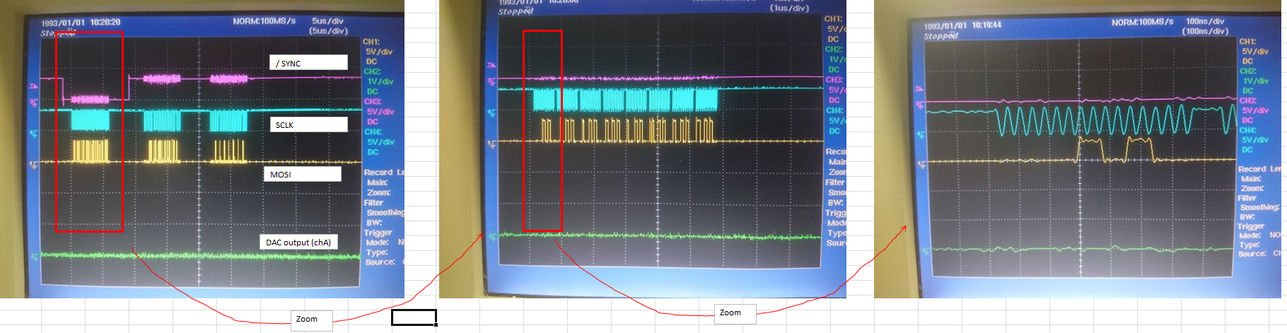

    The customer can't see the 0.5V (0001100110) in their test when DAC output simltaneously.
    Test condition is as below.
    - SCLK : 25MHz
    - /SYNC : Change to 1 after DAC output simultaneously 8ch
    The waveform is below.
    Could you give your advice why the output is not correct?
    Yoshi
  • Hi Yoshi,
    As I mentioned earlier, this device has two modes of operation, one is WRM and WTM. By default on power up, its in WRM mode which means after writing into registers, you need to change mode to WTM by setting DB[15:12] to"1001". If you want change the values immediately after write, do the following steps.
    1. Power up the device
    2. Change device mode to WTM by setting DB[15:12] to"1001"
    3. Start writing into register by bringing SYNC low and making at high after 16clk cycles.
    4. Corresponding output will be reflected immediately.
    Check this for one channel as a debug.
    For simultaneous update of all channels please read through the description given in datasheet page number 19.
    AK
  • Hi AK,
    Thanks for your advice. The customer can see the output correctly.
