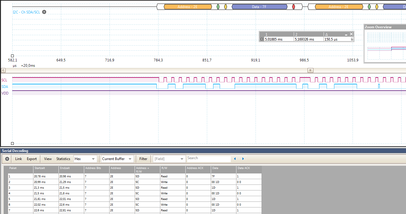

TPL0401A-10: default value of the wiper after reset
Part Number: TPL0401A-10

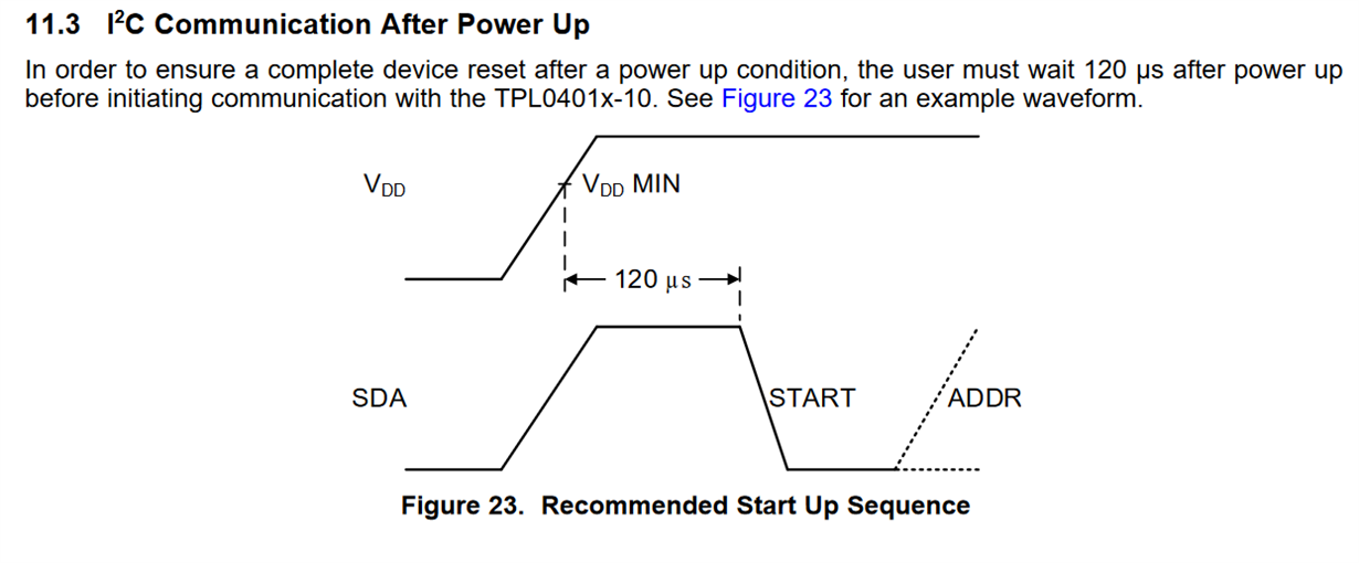

according to the datasheet the default POR value set in the register 0x00 should be 0x40. I am trying to read always the value at the startup but i am getting always 0x7F (the maximum value of the wiper)? can any one explain it to me?
Thanks a lot in advance.
