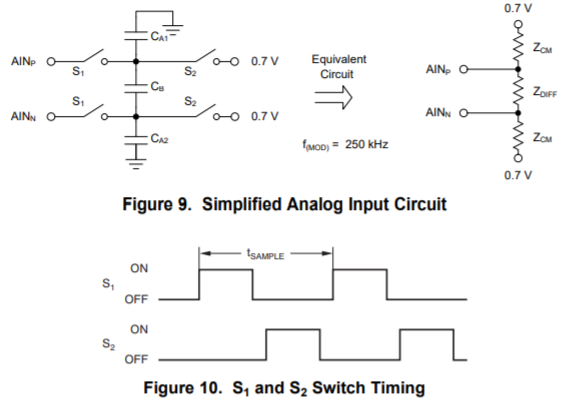

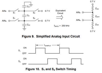

    Is your customer worried about the loading of the resistor divider by the ADC input? If this is the case, the input currents going into the ADC appear more like a resistive load on the divider. The input for ADS1018-Q1 uses a switched cap for sampling the input voltage. Because of this, the input appears as an input impedance with differential and common-mode components. From the inputs, it appears like this as a schematic:

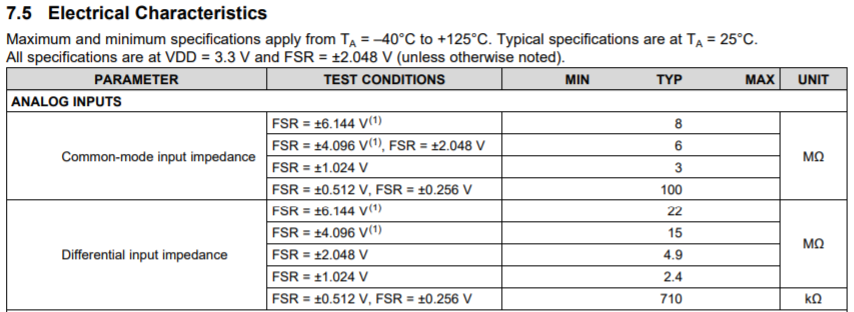

    These impedances depend on the FSR range. They are listed in the Electrical Characteristics table here:
    If the input is connected to a resistive voltage divider, then the input currents from these equivalent resistances will cause some error. For this reason, you would probably want to use resistors lower than 100k depending on the FSR. With the diagram in the datasheet and the values in the Electrical Characteristics table, your customer should be able to calculate the error based on these numbers.
