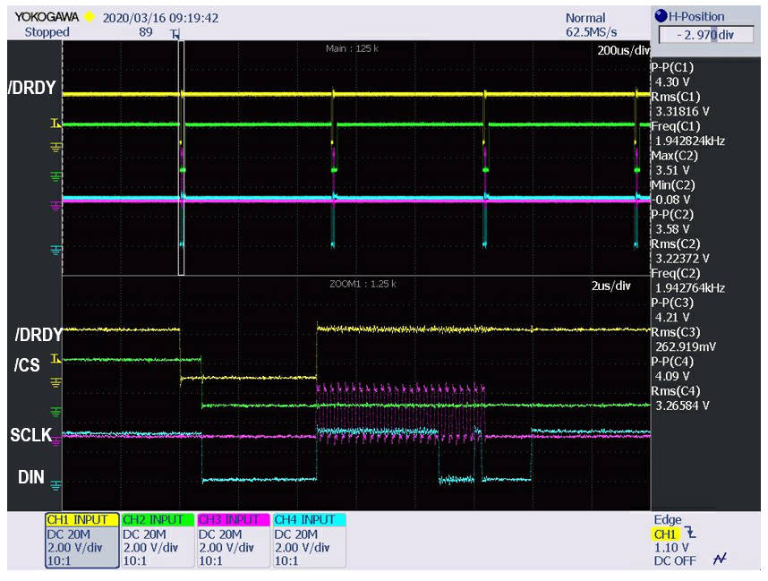

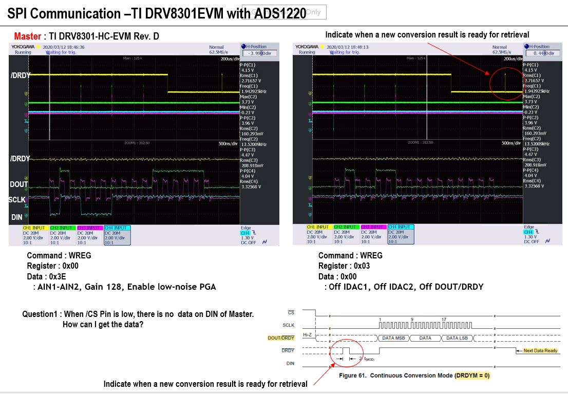

I try to get the sensor data from ADS1220 by SPI Communication on DRV8301-HC-EVM.
I modified the SPI-A Port (J8) of the DRV8301-HC-EVM. First remove the chip U5 and connect the wire to the ADS1220 Module.
I sent the command to the ADS1220. It works and response. But, I can not read the conversion data. There is nothing on DOUT channel from Slave.
What is the problem?
Below the captured image.

  • Hi Jaehoon,
    When you see DRDY transition from high to low as you show in the figures, this means that the new conversion result data are ready to be retrieved from the ADS1220.  The key word here is 'retrieved'.  You must use some action on the SPI bus to retrieve the data.  The ADS1220 is not an SPI master, but rather a slave.  The ADS1220 cannot initiate SCLKs.  So just like when you read or write the configuration registers you must use a similar action by initiating the transfer by the micro.
    There are two different methods to retrieve the data.  One is by reading the data direct.  This is accomplished by setting CS low and by transmitting 3 dummy bytes (NOP) of data to initiate the SCLKs.  After the 3 bytes of data are received you then set CS high.
    The second method is to use the RDATA command.  Using this method you set CS low and issue (transmit) the RDATA command followed by transmitting 3 dummy bytes (NOP) to the ADS1220 and then after the data are received you set the CS high.

  • Hi Bob.
    Thank you for your help.
    I tried the method of reading the data direct.
    First, check the /DRDY by external interrupt 1.
    Send, set CS low and by transmitting 3 dummy bytes (NOP) of data to initiate the SCLKs.  read the buffer when the RX interrupt occurred, After the 3 bytes of data are received , set CS high.
    Here is the codes and captured image.
