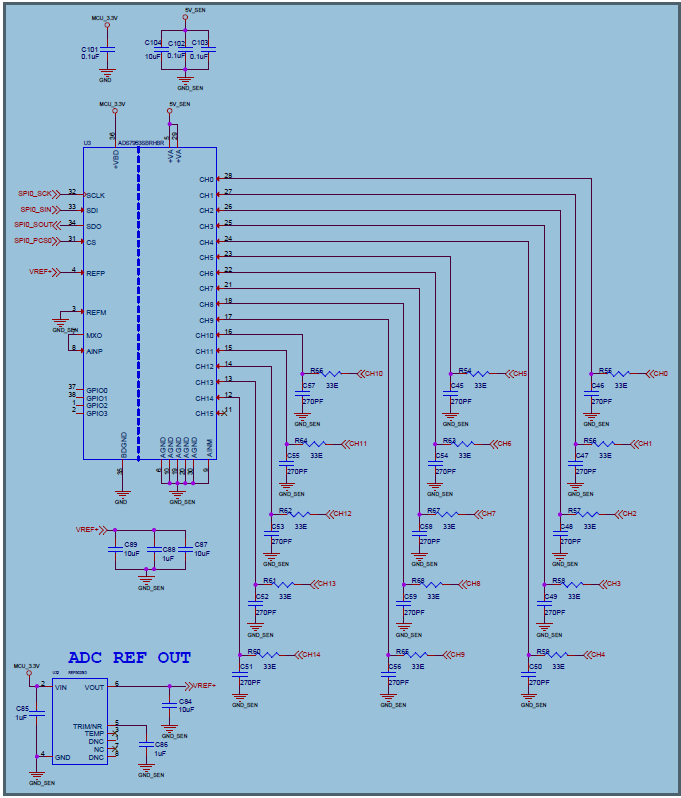

Hi Texas Team,
I have selected ADS7953SBDBT TSSOP Package 38Pin in my design where i need to read 16Channel Input from Gas Sensors which are ADC inputs (0.1VDC, 0.25VDC, 0.5VDC and 3VDC) interface to MicroController via SPI.
Find the attached Analog Input Schematic which i had designed for this 16Channels.
Clarify whether any OPAmp circuit is required in the input Stage for this specified voltages.Waiting for your reply as earliest .
S.Kumar
    If all the inputs are DC inputs, an op amp should not be needed.
    the Capacitor selections looks reasonable at 270pF, but I would like to confirm that what the value of the resistor value is
    Is the resistor a 33ogm resistor? What sampling rate are you using?
    Are you seeing any issues with the measurements? Or are you looking for a schematic review?
