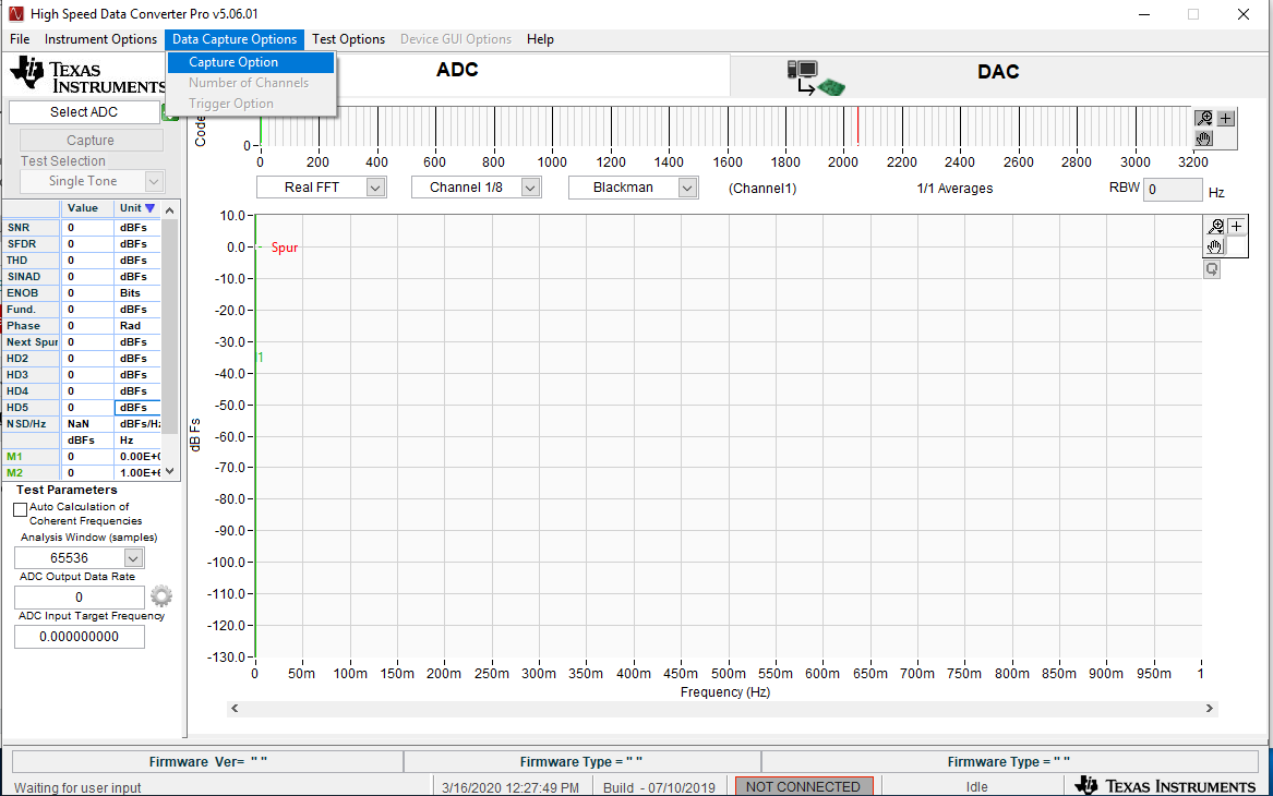

As the ADC has very low memory, I want to save the real time data stream from "high speed data converter pro" software to my PC. But the "continuous capture" option for data capture does not serve that purpose. So what is the alternative ?
  • Hi Ankan,

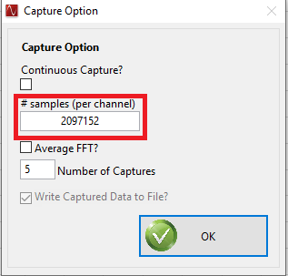

    How big of a capture sample do you want? TSW14J57EVM has DDR RAM and you should be able to do up to a 2M sample capture on the TSW14J57EVM. You will have to click Data Capture Option -> Capture Option.
    Please write 2097152 in the box for # Sample( per channel).

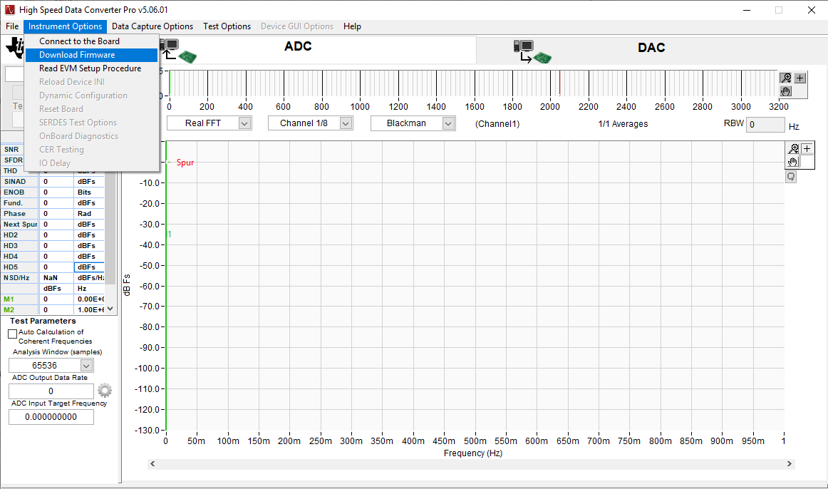

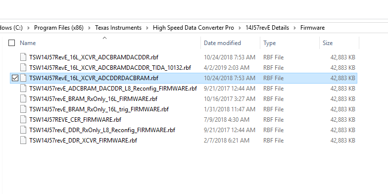

    You will also need to use a different firmware to get this bigger capture. To do this select the ini file for your specific mode and let the firmware get loaded automatically and once the firmware is loaded you will need to manually download  you will need to go to Instrument Options-> Download firmware.
    The file selection window will option and please select the firmware shown in picture below.
