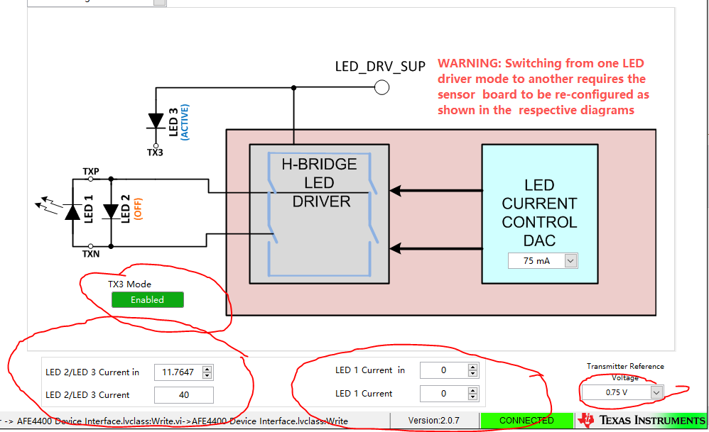

Hi Team,
Customer used AFE4403 and SFH7050 to collect pulse wave signals. He encountered some problems while setting the register parameters. Regarding the parameter Ambient-cancellation current, his understanding is the ambient light cancellation current, which can be set by SPI, the range is 0 ~ 10uA.
Question:
1. How does this adjustment affect pulse wave acquisition?
2. Adjust from 0 to 10uA from large to small. How does this change the voltage collected by the ADC? He emphasized the SFH7050 light to the minimum. He covered the photosensitive part of the front side silicon photocell with black tape. He set the cancellation current to 0-10uA. And he found that the ADC output is as shown at 0-6uA, and the output is all zero at 7-10uA.
