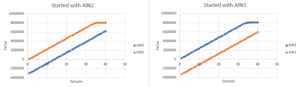

    Captured data with the given settings:
    There is a different behaviour of the symmetrical channels. One of the channels starts negative and is not able to settle within the 40 taken samples. The other channel settles after appr. 35 samples. The behaviour can be moved via software from one channel to the other (dependent on which one was measured first). If both channels are measured correctly, the input voltage is measured as 8030800 (AIN2) and 8039358 (AIN3). The measurement timing is the same on both channels. One measurement cycle on a channel takes 3.163ms. A DMA transfer is triggered via the "Data Ready" signal in order to read the value.

  • Hi Tobias,
    The drawing did not come through.  Save the drawing as a picture then attach.  I think part of the problem may be the use of VCOM as an input.  I would highly recommend not using VCOM in the measurement but instead use the 2.5V reference output of the ADS1261. VREFOUT can be connected to one of the other analog inputs.  You can repeat the measurement with the mux settings to use the input channel for the REFOUT connection.
    I may have further or possibly a better suggestion based on how the input is being connected and measured.  Initially the comment was made that the input should be near 0.  However, based on the data the converted value settles near full-scale.  You also made a comment about viewing the communication with a logic analyzer.  Can you provide this data?

  • Hello Bob,
    we used the internal reference (REFOUT connected to AINCOM) in the first place but decided to switch to VCOM in order to have a ratiometric measurement. We didn't do a lot of testing with this configuration, hence we assumed the behaviour of  VCOM is the same for the other inputs as well. You are absolutely right about VCOM. I added a fixed resistor divider to AIN0 and used it instead of VCOM. Already the first conversion can now be seen as settled. This is the behaviour which I expected. Do you have any details why the usage of VCOM is causing the described effects?

  • Hi Tobias,
    Ok, now I have a better understanding.  Unfortunately I do not have specifics available to me with respect to how the VCOM circuit is implemented.  Generally the resistor values are quite large to limit current in the voltage divider to save power.  Also there is no accuracy specification as to the matching from device to device so your use case would be better served by an external source.  Internally the IC pathways can have considerable resistance and capacitance and when switching from one input to the next there is a differential current due to the input sampling that takes time to settle.
    Using an external voltage divider should be a much better approach as opposed to using the internal VCOM.
