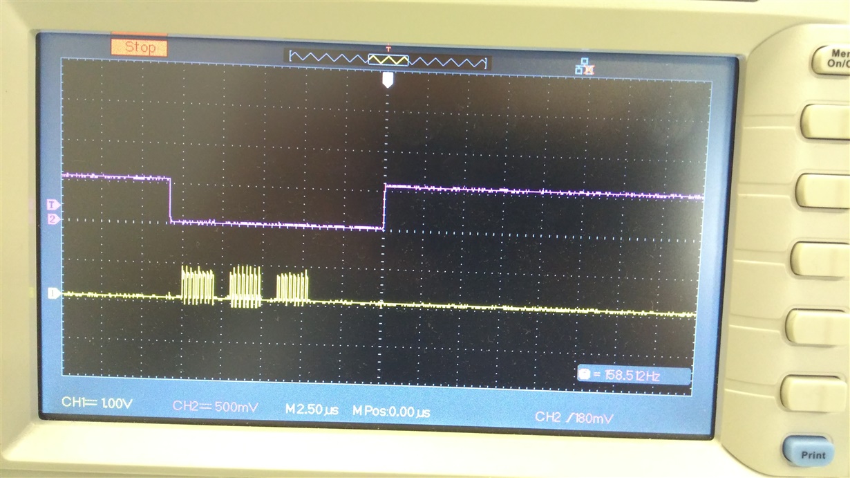

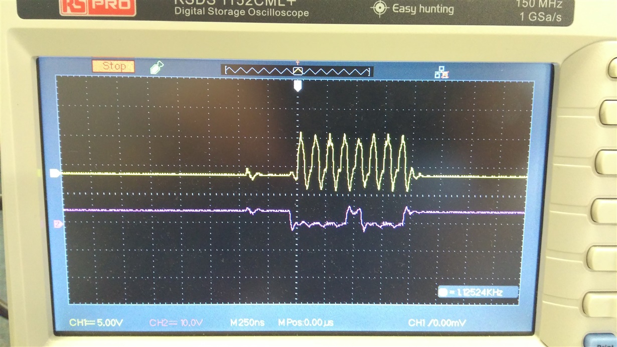

    Here are the scope shots:
    CLK and SDI
    SDI and CS
    And the photos of how it is actually connected:
    Thank you for your help. I really appreciate it.

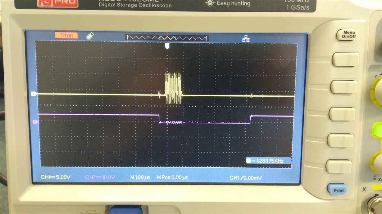

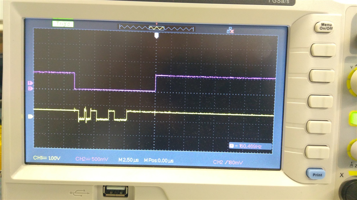

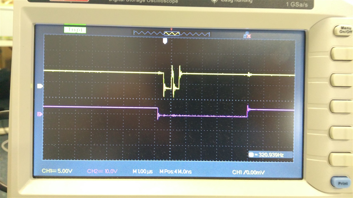

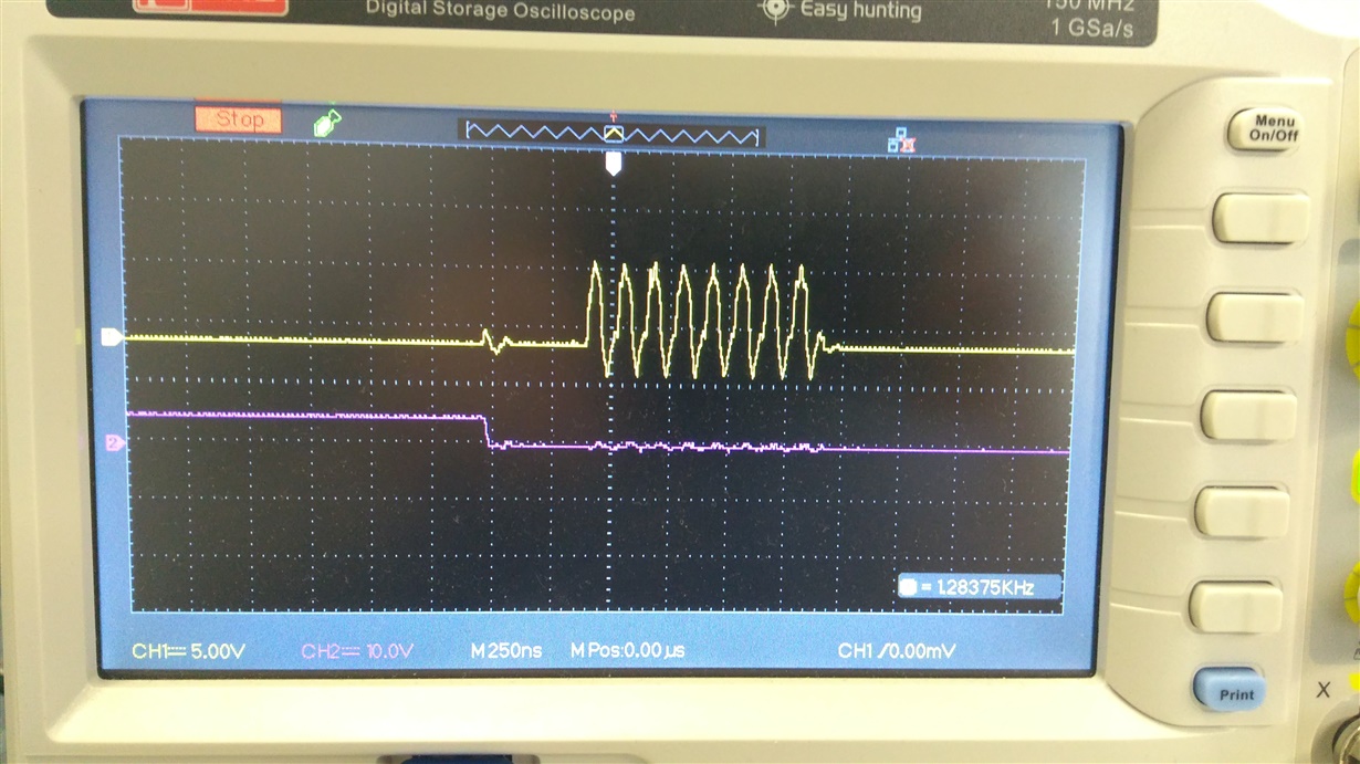

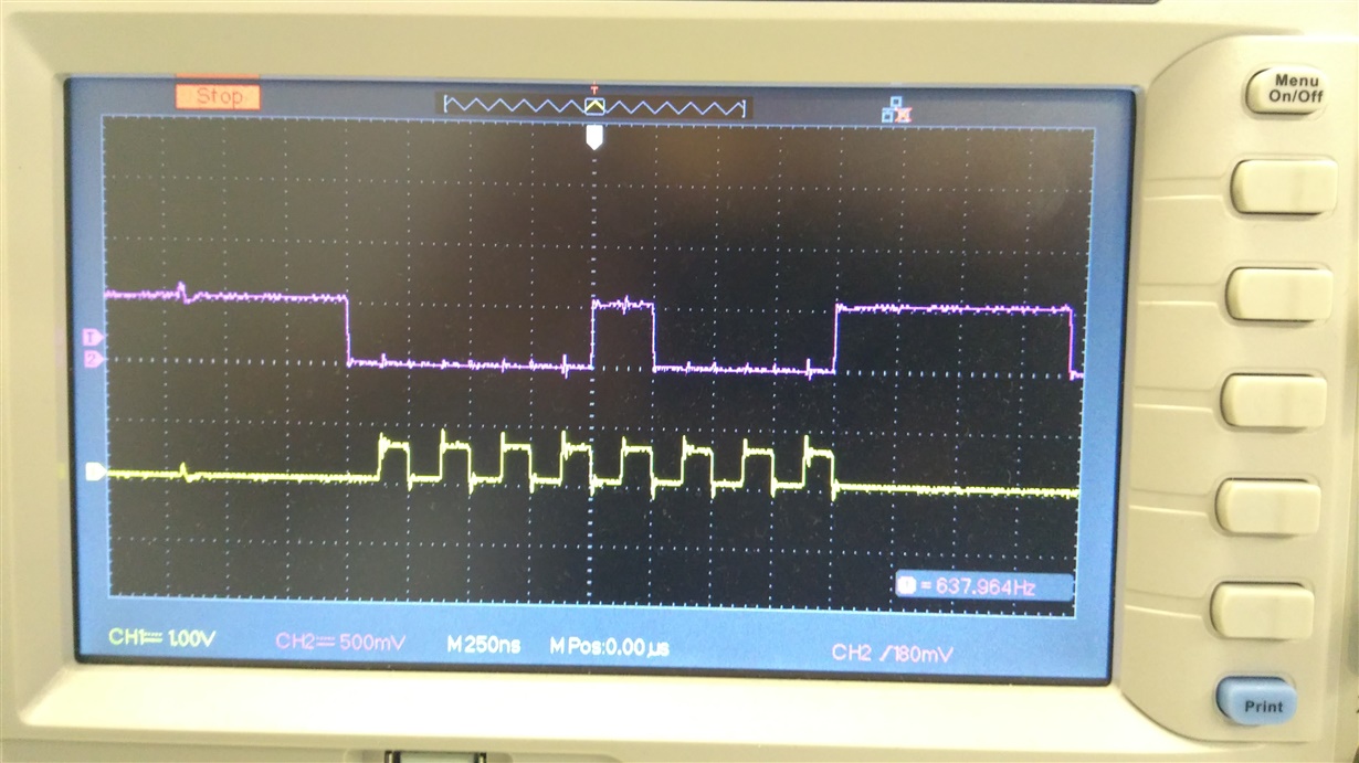

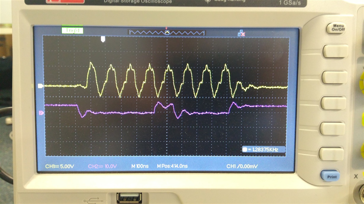

  • Hi Akhilesh,
    Here are the scope shots: Note - I am sending 0x08 via SPI.
    SDI and CS
    SCLK and SDI
    SCLK and CS

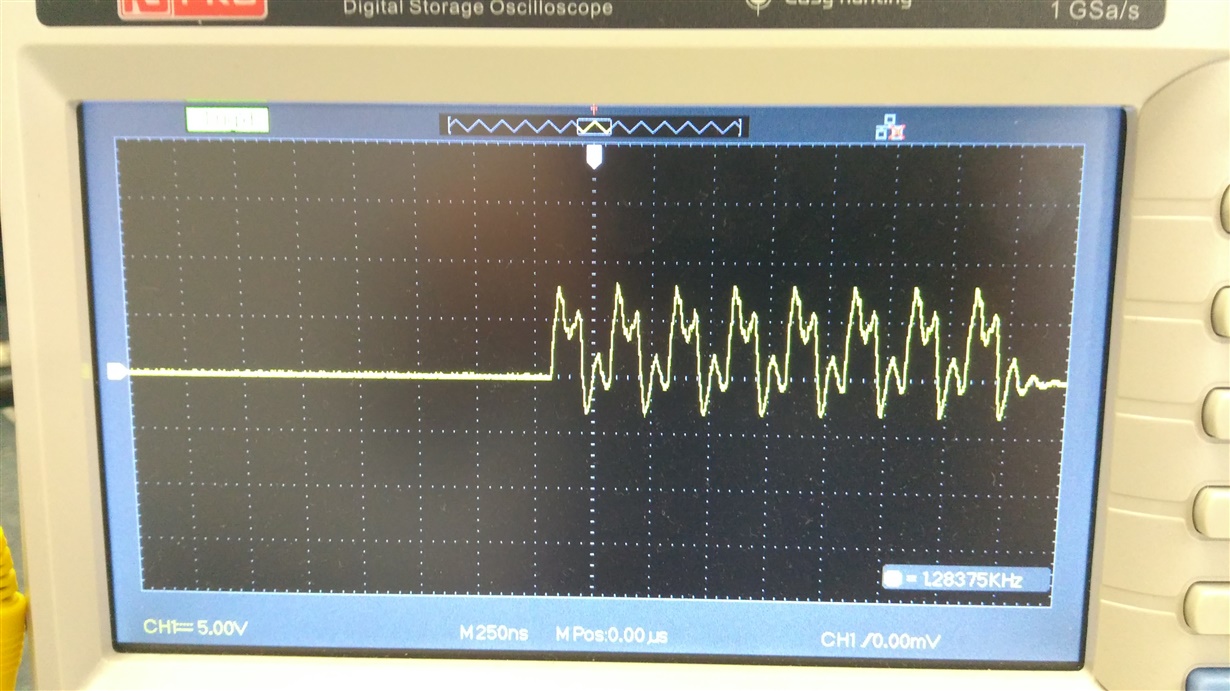

    I am not sure why do they look so bad. The clock signal doesn't even have a pulse shape.
    I commented the line in the code: SPI.beginTransaction(SPISettings,MSBFIRST;SPI_MODE0)); and now the SCLK looks like this:
    Kind regards,
    Dejana
  • Hi Dejana,
    From the scope shots its clear that you are giving only 8 clks for the device where as for our device minimum is 24 SCLK, otherwise frame will be ignored.
    A serial interface access cycle is initiated by asserting the CS pin low. The serial clock SCLK can be a continuous or gated clock. SDI data are clocked on SCLK falling edges. A regular serial interface access cycle is 24 bits long with error checking disabled and 32 bits long with error checking enabled, thus the CS pin must stay low for at least 24 or 32 SCLK falling edges. The access cycle ends when the CS pin is de-asserted high. If the access cycle contains less than the minimum clock edges, the communication is ignored.
    Please give 24bit SPI frame and let me know.

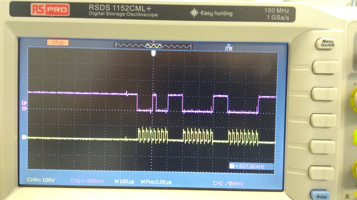

  • Hi Akhilesh,
    Here:
    CS and SCLK
    SDI and SCLK
    CS and SDI

  • Hi Dejana,
    we need continuous 24bit SPI frame , I can see you are sending data in groups of 8 bits, can you send continuous 24bit SPI frame?
    AK
  • Hi Akhilesh,
    You are right, continuous SPI frame is needed! I am trying to send it via Arduino Uno, but apparently all of the built-in functions are adjusted for sending only one byte at a time.
    Since I wanted to use this DAC with TMDSEVM6657LS anyways (I wanted to use Arduino first to better understand the SPI communication to this DAC), I will try sending the data with TMDSEVM6657LS directly. Hopefully the problem was with not using the continuous data frame.
    If I need more help with this, I will make a new post for the connection of the TMDSEVM6657LS and DAC.
    Thank you for your heelp, I really appreciate it!
