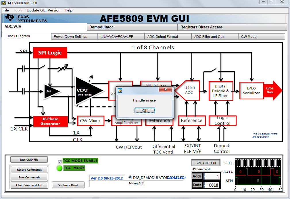

When I Launch AFE5809 GUI,an  error occurred
error 1 occurred at FTDI Error Handler.vi
error 1 occurred at FT_SetBitMode
Set Bit Bang
then I click the "continue" botton,the error shows again
How to continue to use the GUI

  • Hi
    The following picture is the screenshots of
    1.  Error Popup in the GUI
    2. FT_Prog after population of devices
    click the ‘’continue“” button,the following error shows
    The PC is already recognized  the  AFE5809 EVM and TSW1400 EVM
    thanks!
    best regards
    Jason

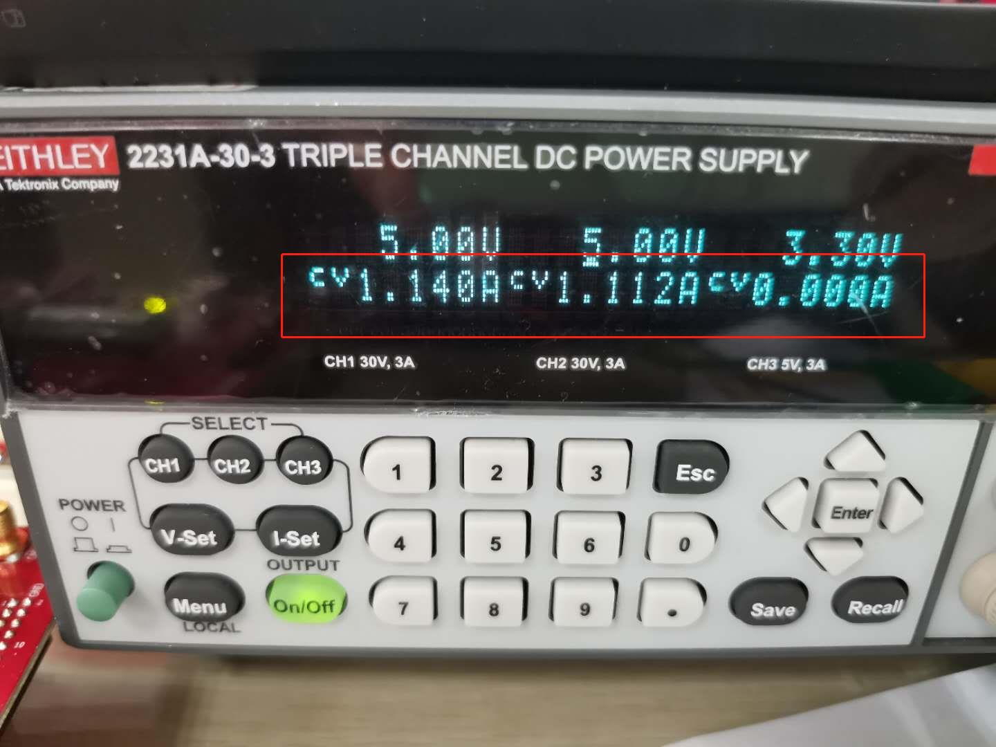

  • Hello
    I have received the information you sent, thank you!We are still a little confused in the use of the board.
    After the AFE5809EVM is normally powered and the software is opened, the main chip, namely AFE5809,
    is very hot.After looking at the current of the power supply, there is more than 1A, I want to ask whether this
    is a normal phenomenon?
    Yes, that is possible.
    Because in the board, its power covers more than device itself only.
    also it can depend on how many channels you are using.
    So for the device's power consumption, please refer to the datasheet page 15 and page 16.
    Thank you!

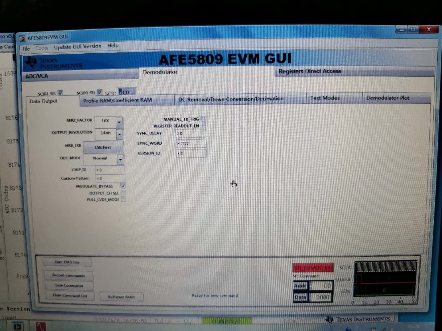

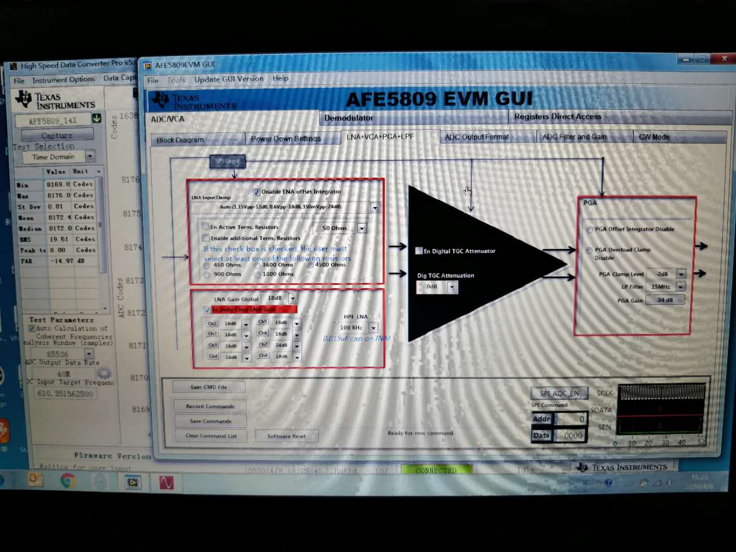

  • Hi
    We tried to use the signal generator to generate a sine wave signal and add it to the CH1 of AFE5809EVM,
    and then to capture the signal on the software interface of TSW1400, but we felt that the signal captured was abnormal.
    We set up the following on the GUI of AFE5809,Are there any problems up here
    How are you?
    Looks like on your Tek signal generator,
    could you please change using its "Burse" button
    and please press "Continuous" button?
    Hope this can help.
    Thank you!
    Chen

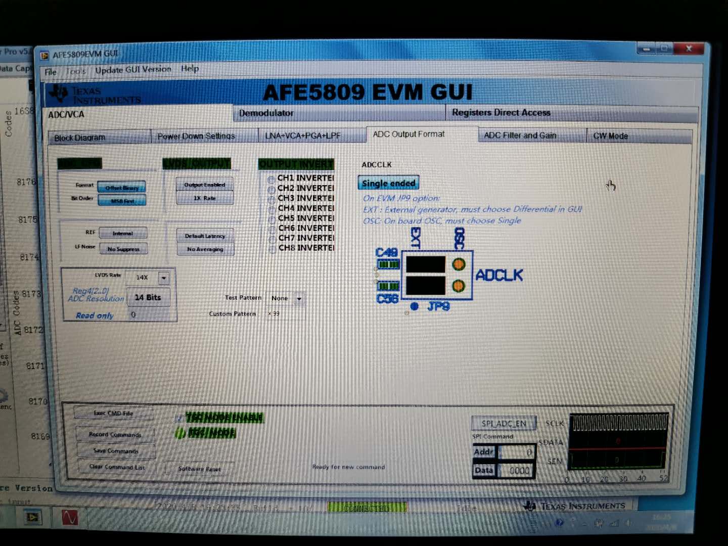

  • Hi
    We bought a new AFE5809 board, turned on the electricity to open the GUI, everything can run normally,
    so we think our original board should be broken.
    Sorry, we just want to confirm with you what is going on from the EVM you ordered.
    Therefore, according to your reply, the AFE5809EVM board after the messages from our suggestion
    still is not working. Right?
    Thank you!
    Chen
    also could you please forward your email address?
    Thank you!
    Chen
  • Hi
    We have made some adjustment according to your suggestion, but the result is still not good.
    We have sent the board to the local after-sales technical support to check the problem.
    They think the board's USB port is broken.
