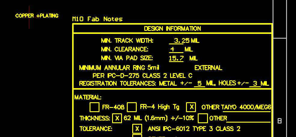

    I got all the details except the following,which is i am finding in EVM design files.
    1.Which PCB dielectric material suggest for ADC12DJ5200 for high speed (sampling clock : 5.2GHz) ?,to avoid signal loss.
    2.What is the maximum tolerance do we have to maintain for SYSREF & DEV CLOCK groups.
  • Hi Sangeeth,
    The PCB material is stated in the gerber file download specificed under the fabrication notes, it is Meg6.
    See attached.
    As indicated there is no max tolerance to maintain between the SysRef and Dev Clock groups because all applications will have different layout constraints to work within on their system boards,etc. Timing adjustments to capture the data correctly are made either on the clock signal chain (LMK & LMX parts on the EVM) and/or in the FPGA.
