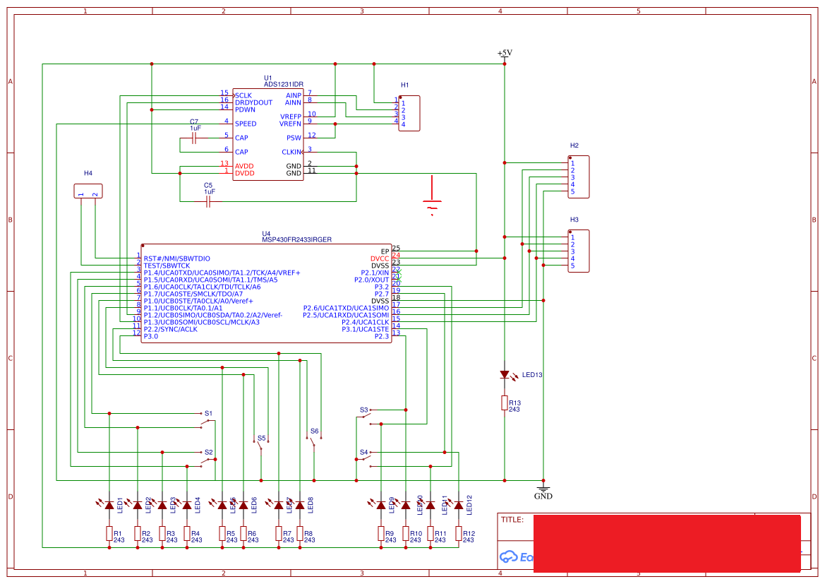

Hi I have an ADS1231 connected to an MSP430FR2433 in a circuit that is similar if not identical to the reference design.
Essentially I have a load cell connected to the ADS1231 which feeds to an MSP430. There are also some switches and LEDs at the bottom which you can ignore.
As you can see, the data rate is set to the slower 10Hz rate. I'm using the internal clock.
I have SCLK feeding to and output on the MSP430, and DRDY/DOUT to an input.
This is all on a 2 layer PCB. The two chips are 10 mm apart.
Power is USB via a Launchpad @ 3.3V.

  • Hi Yvan,
    Welcome to the E2E forum!  You are actually using the wrong connections in your code for the pins connected to the ADS1231.  For example, P1.3 is defined in your code as DOUT but this pin is actually connected to the SCLK pin on the ADS1231 in the schematic. The P1.2 pin is defined as CLK but it is actually connected to DRDY/DOUT.  If you change the labels in the code I think it may work.  So CLK should connect to P1.3 and DOUT to P1.2.
    Bob B
  • Wow Bob, thank you so much.
    The funny thing is that that is the first thing I looked at. In fact I was using pin numbers before I started using the pin aliases, and switched to the aliases because I was sure I had the wrong. I guess I just needed a fresh pair of eyes.
    Thank you again for the very prompt response and solution.
