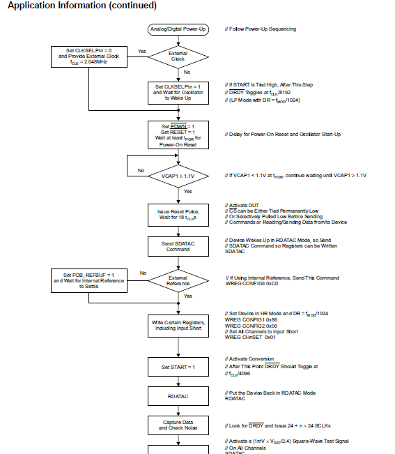

i am trying to use ads1294 to capture data in continuous and i use the flowchart in datasheet.
for test signal :
CONFIG1 --> 0x86
CONFIG2 --> 0x10
CONFIG3 --> 0xC0
CHnSET -->  0x05
i use stm32f407 for programing and capturing data and i connect  DRDY to EXIT3(pullup and trigger in falling edge).
DRDY toggle at fclk/4096.DRDY pin stop toggling when i read data!!!

void HAL_GPIO_EXTI_Callback(uint16_t GPIO_Pin){
    s++;
    if(s>=488){
        s=0;
        ss++;
    HAL_SPI_Receive(&hspi1,STAT,3,100);
    HAL_SPI_Receive(&hspi1,CH1,3,100);
    HAL_SPI_Receive(&hspi1,CH2,3,100);
    HAL_SPI_Receive(&hspi1,CH3,3,100);
    HAL_SPI_Receive(&hspi1,CH4,3,100);
int main(void){
  HAL_Init();
  SystemClock_Config();
  MX_GPIO_Init();
  MX_SPI1_Init();
  HAL_Delay(500);
    ADS_setup();
    ADS_SetTestSignal();
    id=ADS_ReadReg(adr_CONFIG1);
    HAL_GPIO_WritePin(START_GPIO_Port,START_Pin,GPIO_PIN_SET);
    spi_buffer=RDATAC;
    HAL_SPI_Transmit(&hspi1,&spi_buffer,1,100);
  while (1) {
