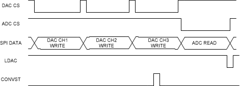

I would like to make a system which generates three different signals at the same time. Currently I am working with DAC80504EVM and as far as I have understood, with this DAC I can either have delayed transmission of three different signals or generate the same signal on all of the DAC outputs, since SPI can provide information about one voltage level at a time.
Since I want to control this generation with TMDSEVM6657 evaluation board, my current idea is to make a custom board with three one channel DACs, so that I can use all three SPI interfaces. I would use one SPI port  and two McBsp ports from TMDSEVM6657 all clocked with the same clock. Does this make sense? I am not quite sure would it actually be possible to make all of it synchronized.

    You can write to three of the channels in three different SPI commands, but then use a single LDAC pin edge or LDAC SPI command to have the three channels update simultaneously.  Generally, the SPI interface is fast enough to support this.  Can you describe your target output frequency or bandwidth requirements?

    I would like to generate three CDMA coded linear chirps (300kHz central frequency with 30 kHz bandwidth) of 5ms duration, transmit them and then receive them with receiving transducer connected to ADS8920BEVM. In the TMDSEVM6657 I would like to do three times matched filtering in order to compute time of arrival and distances between each of the transmitting transducers and the receiving one. In order to compute time of arrival I need to somehow track DAC transmission and ADC reception. Generally I intended to use SPI where they are clocked with the same clock and with DMA it would be quite straightforward. But If I use the option that you mentioned I would need to have 3 transmissions for DAC loading (for each of the registers) and then on the fourth one I would have conversion. I am not sure how would I then synchronize DAC with ADC.

  • If the ADS8920 also has a conversion-start pin or register, then you could do the following:
    1. write DAC channel 1
    2. Write DAC channel 2
    3. Write DAC channel 3
    4. Assert LDAC pin and ADC trigger pin at the same time
    5. Read ADC
    repeat.
    Does that work?
  • ADS8920B has a CONVST pin.
    Conversion start input pin. A CONVST rising edge brings the device from ACQ state to CNV state.
    Therefore, I could connect LDAC and CONVST to the same GPIO pin of TMDSEVM6657 but with an inverter for one of them, since LDAC is active low and CONVST is active high.
    Then I do as you said: 3 SPI transfers for loading the registers, then I send synchronization signal and then I have another SPI transfer to collect new sample from ADC. Then I update DMA buffer with it.

  • I think you need to consider "coherent sampling".  In this case, it seems like you want the DACs to sample at 300kSPS, are you okay with 1 ADC sample per DAC sample?  If so, you could use the CONVST function of the ADS to trigger the sample.  While the device supports 1MSPS, you do not really need it in this case.
    Consider this:
    There is exactly one sample from the ADC per sample of the DAC channels.  You should space the LDAC pulse from the CONVST pulse to ensure that the output of the DACs are settled before you sample.  In this case the ADC would be sampling the previous DAC update.
    Paul

    Note that the DAC80504 has a limited settling time.  We specify 5µs to settle from 1/4 scale to 3/4 scale. If you are trying to generate a 300kHz tone, you will see distortion from the output not settling.
    From a programming standpoint, you could still be able to write to the devices in the method I described.  Now you will have 4, 24-bit commands per sample.  So you will be limited to about 500kSPS.  If you absolutely require 600kSPS, then you will need to implement parallel SPI buses.
    You could use the LDAC pulse as a trigger for the ADC read to keep the two busses synchronized.
