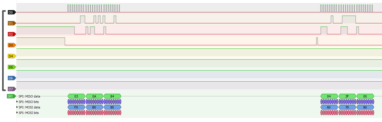

  • Hi Akhilesh,
    Thank you for your reply.
    I changed the Vref to 2.5V.
    I powered up the device (Does that mean re-attaching the Vdd/Vaa)?

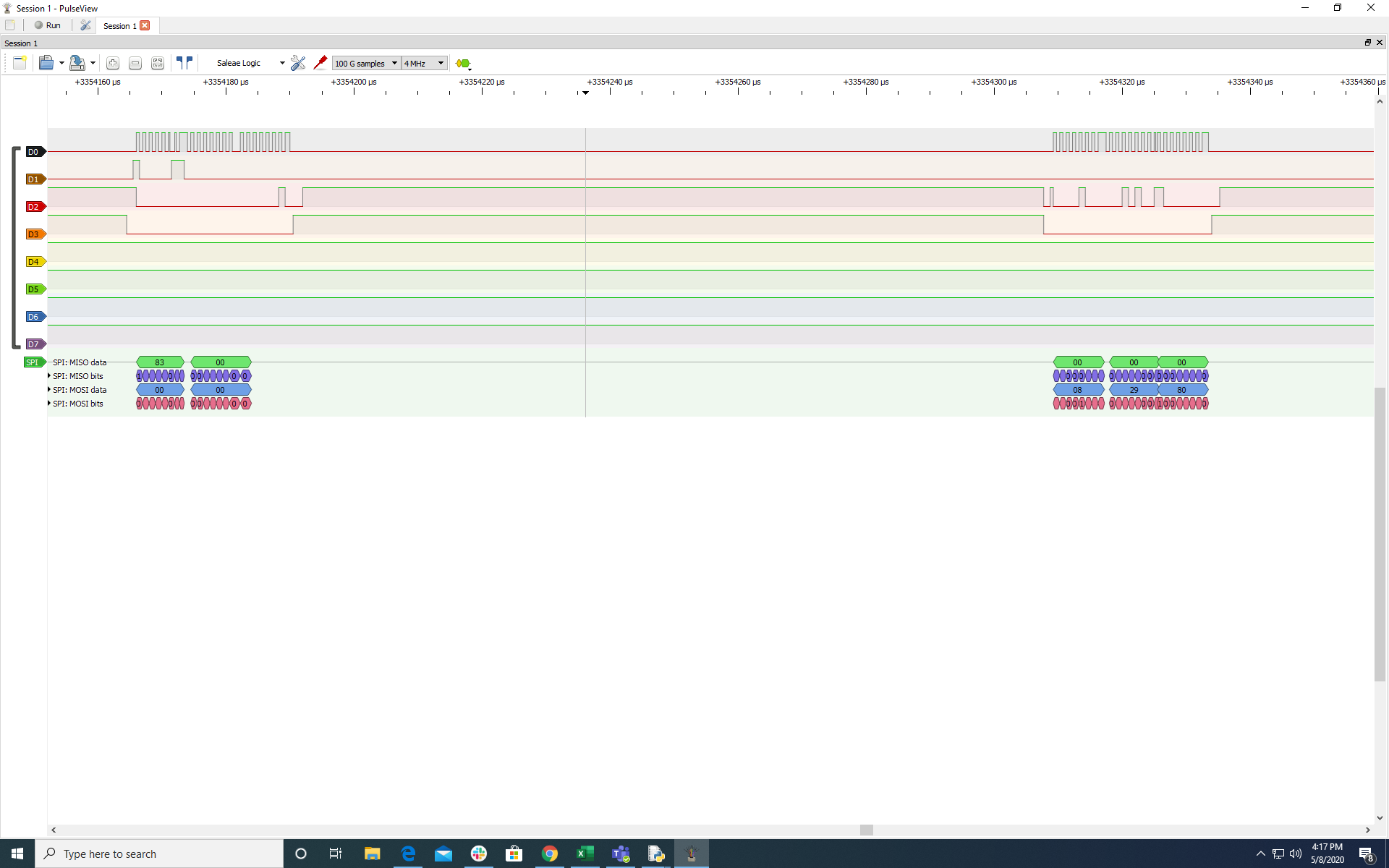

    Then I sent a read command to read SPICONFIG register followed by a dummy command. Now, I am reading everything given in those 3 bytes (even though not precise.. so it's not accurately reading! but it is following the same pattern). The thing is, when I set the highest bit to 1, it should read and "ignore" the last two bytes. In my case, it is following everything and it is not returning the 0x0A24.
    I have attached four different SPI frames.
    Thank you,
    Sahra

  • Hi Afshari,
    Did you got internal reference enabled and checked for 2.5V? That confirms your write is working fine. Please do that before going into external reference mode.
    Also your read should work fine and get the register data. Unless you validate your SPI frame and get these correct, debug will be difficult.
    what SPI mode are you using. We prefer SPI mode 1 and 2, not 0 and 3
    There is no specific power sequence requirements as such although we prefer supply to be stable before you apply reference.
    But please verify everything with internal reference and then we can move forward to external reference.
    AK

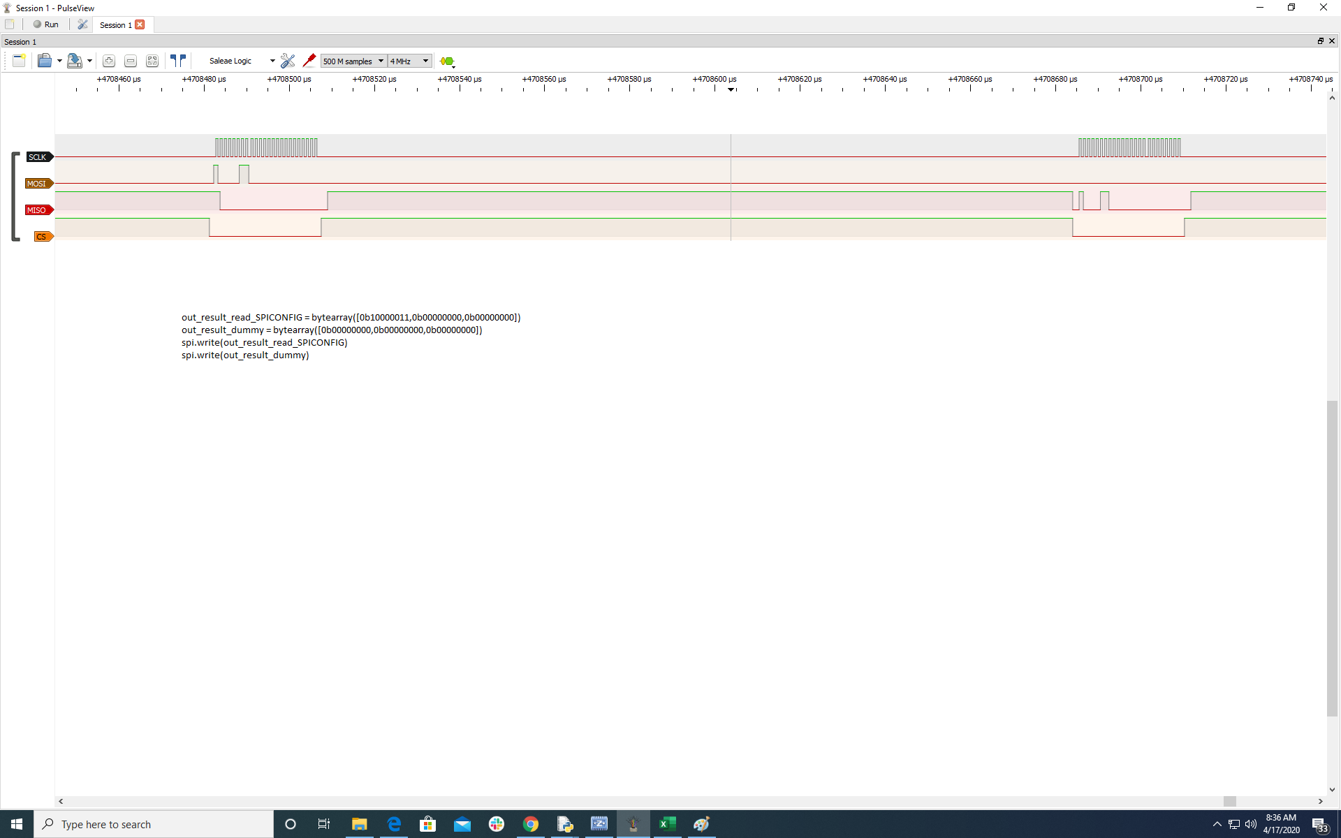

  • Hi Akhilesh,

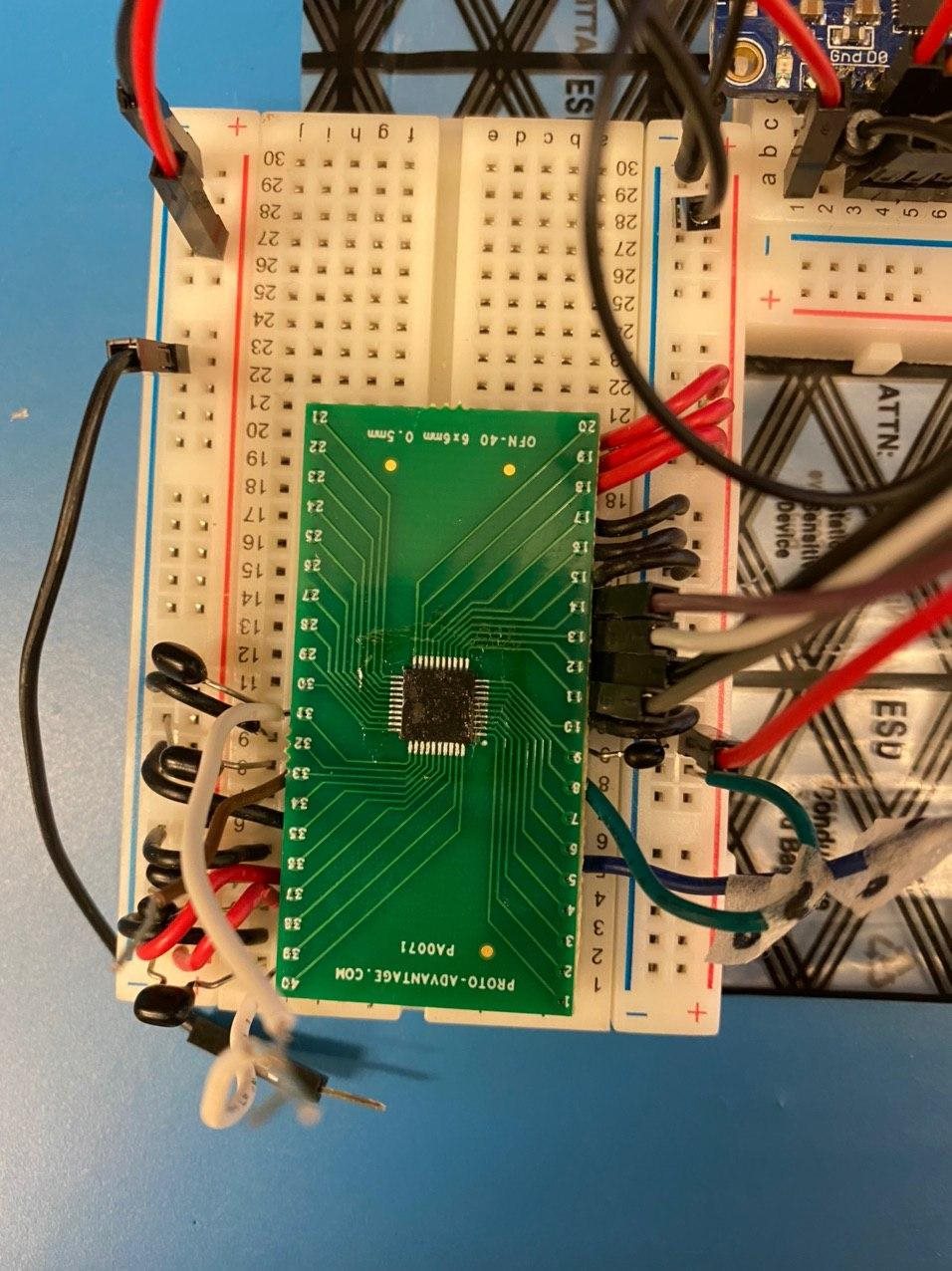

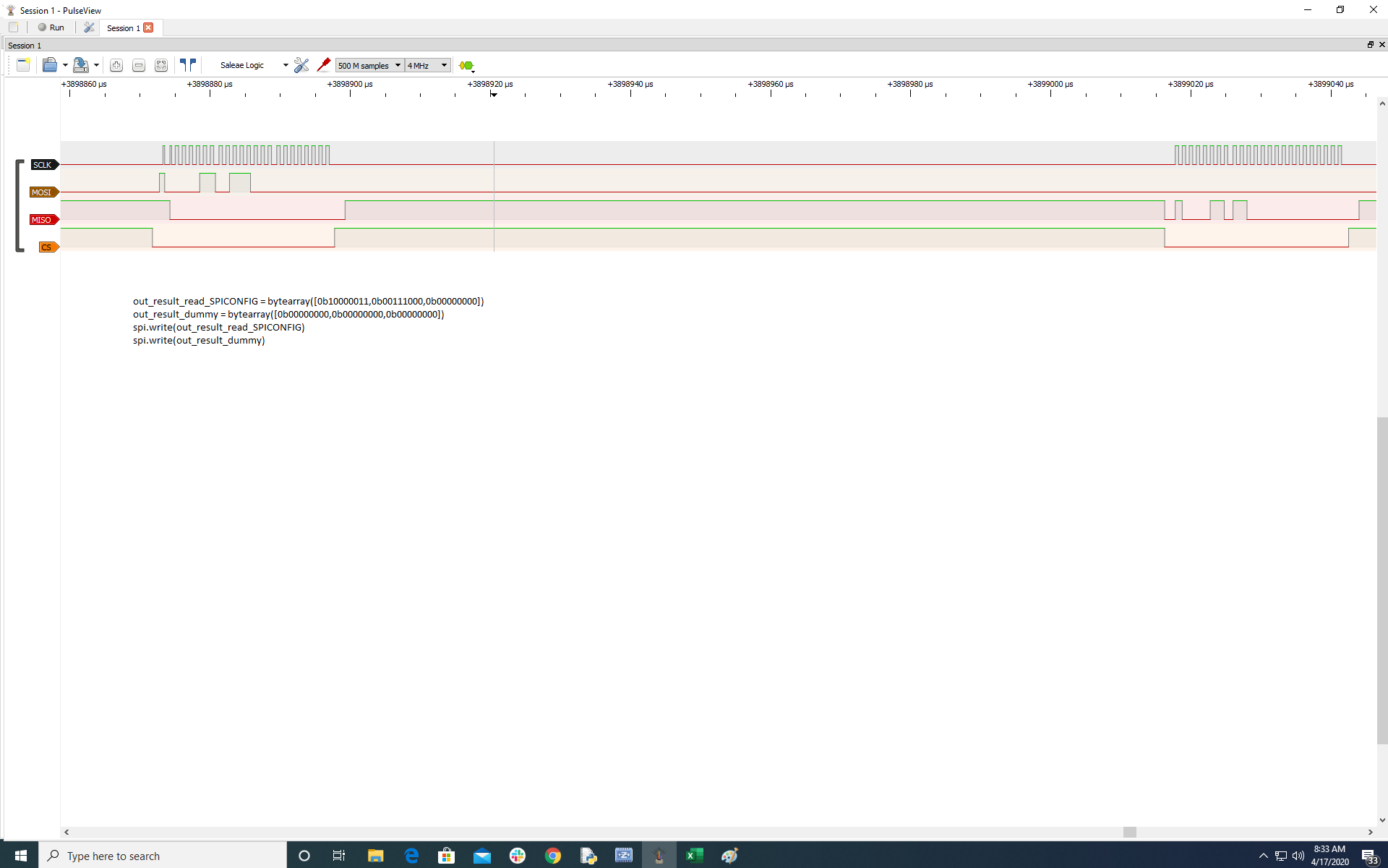

    I have attached three photos to this response:
    1. The circuit schematic (I use 100nF instead of 150nF for REF, and 470pF instead of 300pF for REFCMP. I don't have those exact capacitors)
    2. The DAC on prototyping board.
    3. SPI frames I sent to DAC.
    So this is what I did in the code:
    1. connect the device.
    2. Write in SPI CONFIG  register (0x03): 0x0A84 (Device in active mode)
    3. Write in GENERAL CONFIG register (0x04): 0x3F00 (Internal reference is enabled)
    I checked the REF, and it is showing 0V. The result is same for both DACs.
    Please let me know what is going on.
    Thank you,
    Sahra
    With this prototype board, I am not seeing any decoupling capacitors, reference capacitors placed close to the device. This can cause issues for you.
    Please add capacitors near to device. Also can you probe your SPI signals near to device and get scope shots, rather than logic analyser plots.
    I cannot make any comment on these plots. Do you have EVM with you right now?
    AK

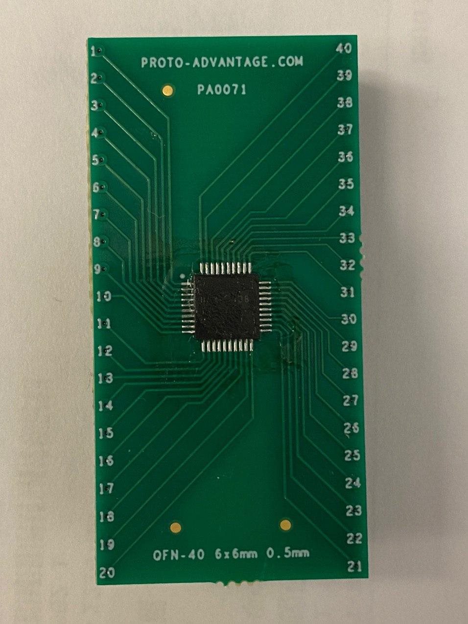

    What do you mean "close to device"? I put the IC+prototyping board on breadboard and add caps there. I've attached a picture.
    Also, with SPI and logic analyzer, I have been using this method for other DACs and ADCs, and it's working fine.
    Yes I have the EVM with me.
    What I mean by close is, caps should have been on the breakout board, not on the bread board.

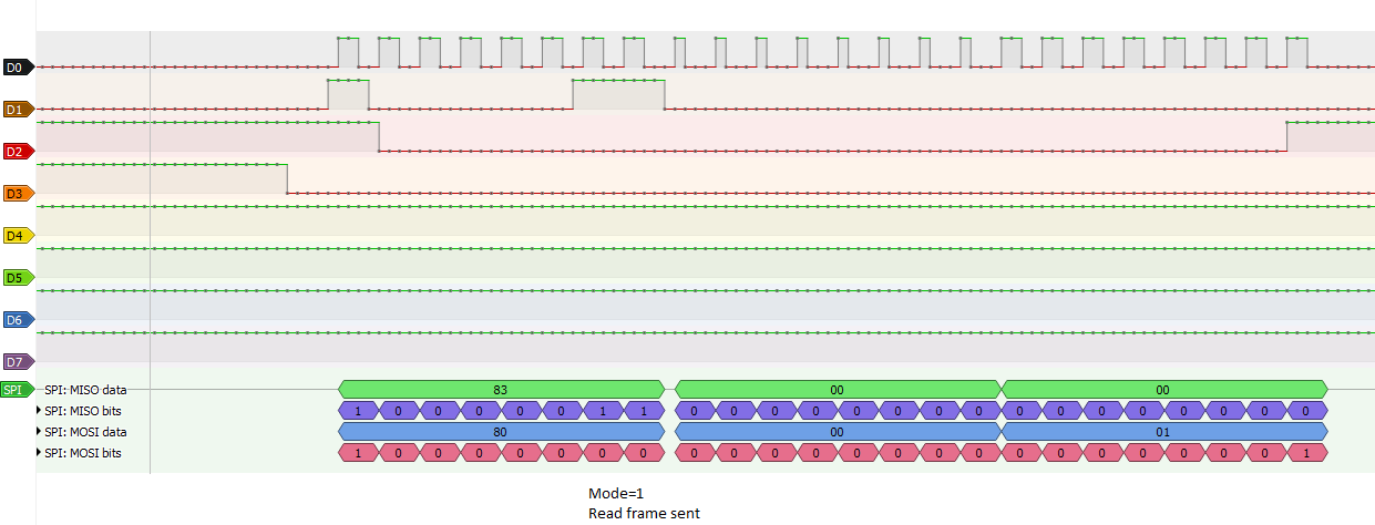

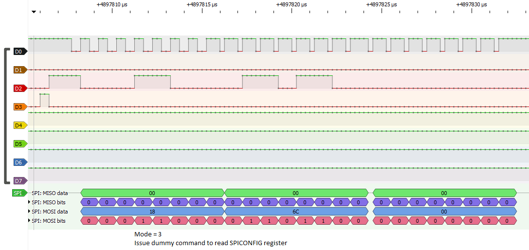

    This device supports only mode 1 and mode 2 SPI protocol. Meaning CPOL = 0, CPHA = 1  & CPOL =1 , CPHA = 0
    In the first case, idle state of SCLK will be logic low and data will be latched on falling edge of SCLK.
    second case, idle state of SCLK will be logic high and data will be latched on falling edge.
    Can you please verify this in your SPI frame?  For check can you reverse polarity of SCLK, start with high state?
    Issue a valid SPI read command  and read some default register
    AK

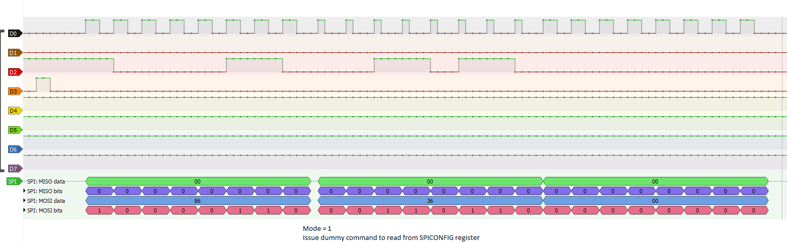

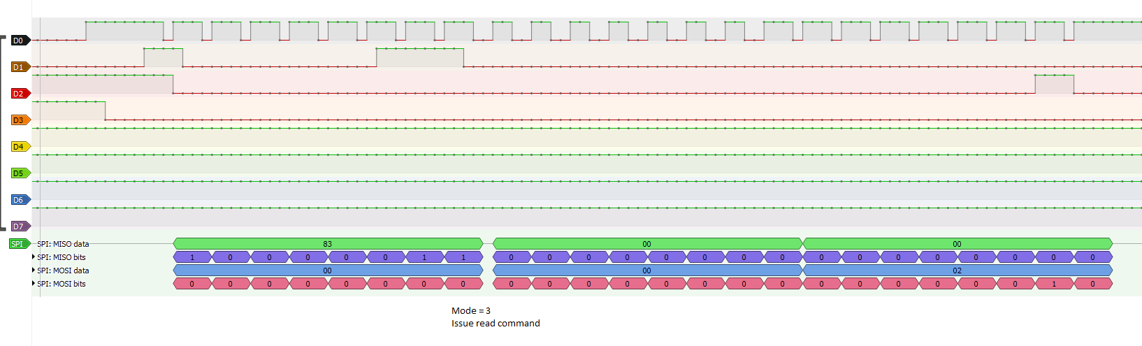

  • Hi Akhilesh,
    So I checked both the modes. What you are asking is mode 1 and mode 3 in my python code. I issued a read command to read SPICONFIG register. Clock and readings are working as you've described. I am attaching the SPI command for each mode (two picture for each mode).
    I'm still not getting any valid read from register though.
    Sahra
    Your read should work fine, between some your clock pulses are wider and others narrower? why is it so? Artifact of your logic analyzer?
    Can you please have a scope shots at the device pin SLCK and CS and data lines?
    AK
