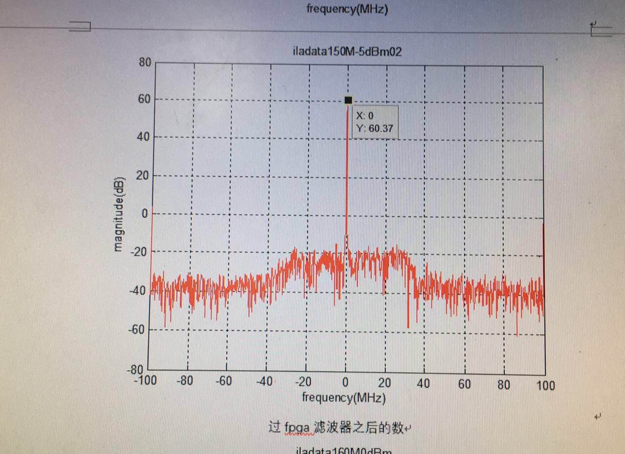

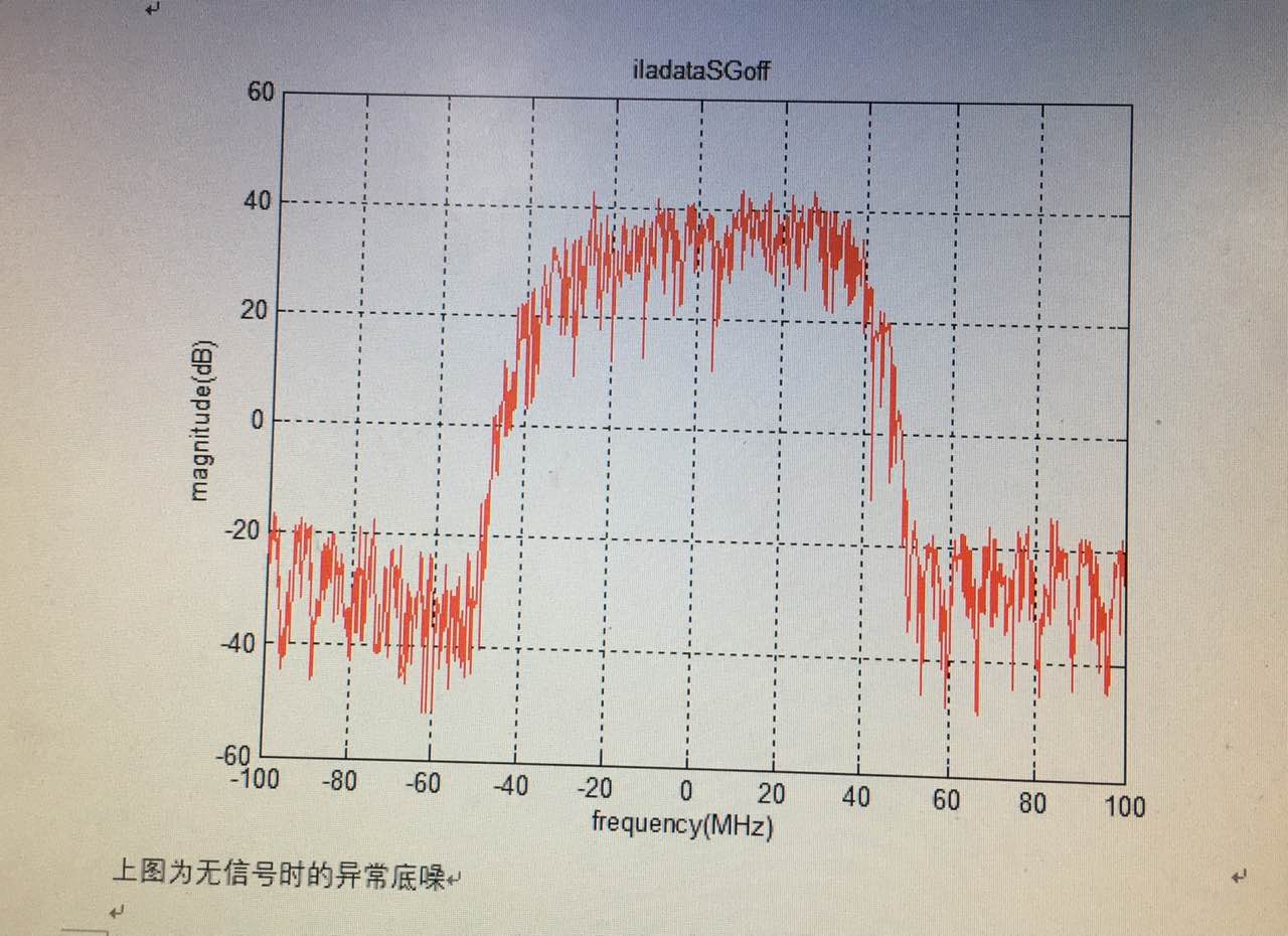

My customer is using ADS4128 and find something strange.
The noise of ADS4128 is very big when there has no input signal (40dB); the 4 LSB has random data but not LVDS data.
The noise of ADS4128 is much smaller when there has input signal (-20dB).
Below spectrum shows nearly 60dB difference between with input signal and without input signal.
Spectrum diagram (with normal input signal):
Spectrum diagram (without input signal):

Could you help explain why there has big noise when there has no input signal? Or check if there has something wrong inside the configuration file?
thanks a lot.
Yang
  • Yang,
    Are the analog inputs properly biased using the VCM output from the ADC? See figure 43 of the data sheet. Is the analog input AC or DC coupled? Have they tried enabling the DC offset correction algorithm?
    Jim
