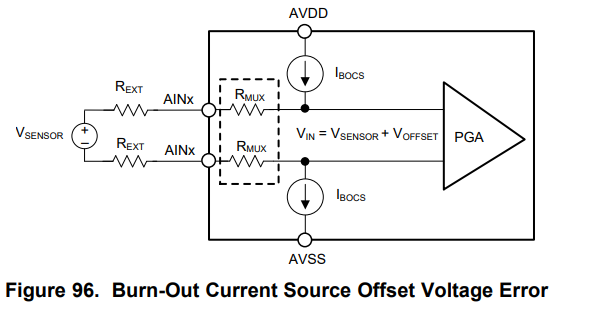

    Also, can you confirm the value of multiplexer resistance RMUX? The datasheets states that "When using the burn-out current sources, be aware of the offset error caused by the currents flowing through impedances in the input path, including the multiplexer resistance RMUX".

  • Hi Carlo,
    The multiplexer resistance RMUX is between 200 to 500 ohms from design perspective as a fair estimation, it depends on the absolute voltage of the input pin.

  • Hi Dale,
    Good day.
    Can you please explain why the  RMUX is dependent on the absolute voltage of the input pin? According to our customer, resistance is an intrinsic property of a material, not dependent on the magnitude of a voltage running across it. If a high voltage is applied, the generated current sufficiently heats the resistor, which changes the resistance, but that wouldn't be expected for the range of inputs expected on the mux pins.
    Carlo
  • Hi Carlo,
    The on-resistance(Rmux) of multiplexer is not constant, it is a function of supply voltage / input voltage since it’s a regular Tgate structure (PMOS and NMOS in parallel turning on through 0V/supply voltage). PMOS conducts for positive input voltage and NMOS conducts for negative input voltage. Rmux is the combination result of both N channel and P channel FETs. Please see following equivalent circuit and corresponding curve.
