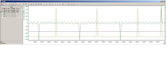

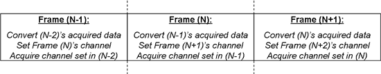

    thanks for your reply! At first an image with the output conversion results at 400V input voltage and an RL-load. In this image, the measurement takes place in a none switching moment. The peaks here are on the divided input voltage (lighter green) and on the divided output phase to phase voltage (darker green). But dependant on the sampling moment (falling CS edge) and the modulation index there are also or only such peaks on the temperature channel (blue). The measured values besides the peaks are correct.
    The input voltages are: 0-5V for temperature measurement (Ch2), 0-5V for input voltage measurement (Ch3) and 0,5-4,5V on phase-to-phase voltage (Ch4) measurement. The analog and digital supply voltages are both 5V and the reference voltage is 2,5V.
    Tobias
  • Tobias,
    Thanks for the screenshot.  I wasn’t able to see all the details, but I am curious what your sampling rate is and how your cycling through the different channels. It appears like only one point is sampled on each peak and that the peaks are cyclical. What values are you expecting instead of the peaks shown in your image? It is possible that the ADS7951 is cycling through channels that you’re not using or not interested in? (You mentioned your inputs are connected to channels 2, 3 & 4; what is connected to channels 0,1,5,6 & 7? Is the part operating in one of the automatic sequencing modes?)

  • Hey Chris,
    thanks for your answer. The peak values are totally wrong, I expect the same values like on the peak's left and right. But the reported values are correct (no peaks) if there is no PWM on the IGBT gates or if the input voltage is below a certain point. So the circuit should be correct. The not used channels are connected to Gnd with a 1k resistor.
    The error pattern is not always the same. The peaks are changing amplitude/frequency with rising input voltage or change of PWM modulation index.
    Here a screenshot of yesterday's measurements (input voltage=50V, modulation index=98%, modulated frequency=200Hz):
    You see the three Gate Signals of the Top-IGBTs (blue, purple, green) and the ADC's MXO output (yellow) which is connected directly to the AINP input. So the faults are also on the multiplexed signal. As you can see in the picture, the frequency of the disturbance is 200Hz which is the modulated sinus frequency of the PWMs.
    I also measured the voltages on the channel inputs and they were free of interference. Also the ADC's supply voltages and the reference voltage are clean. Furthermore, there is no offset betwenn the DGND and the AGND. I don't know where the interference could come from else and am quite clueless at the moment.
    I'll tell you the ADC's operating data later this day and will also post an extract of the schematic.
    the channel is changed with a frequency of 3.75kHz,  every channel is renewed in a rate of 750Hz. It is used in non automatic mode (channel is chosen manually).

    By the waveform on the output above, it seems that you are switching between four channels.  I see the ~3.75k/CH and the rep rate of ~750Hz for the most part.  There are several spots though where you seem to dwell on one channel longer, for instance on the left side where CH1 is high for about 80ns or so.  Is this part of your algorithm?  Can you possibly capture the SCLK, CS and SDI along with the MXO?
    sorry for answering only now. I measured spikes on the chip select line. The distortions on the mux signal appear at spikes hitting the CS signal straight before a rising edge.
    What is inexplicable for me among other things is the amplitude of the distortions on the mux signal. I injected the reference voltage of 2.5V on all chanels of the ADC and nevertheless the distortion's amplitude reaches up to 6V. There is no signal over 5V on the ADC. Anyone an idea?

    The overshoots you see may or may not be real - depends on how you have the board probed.  If you have good (and short) ground leads with low capacitance probes, you may be seeing overshoot simply due to the switching speeds of the clock, the /CS, the PWM - a host of actors can play into this.  Parasitic inductance and capacitance on the board can cause these sorts of problems.  If this amount of noise on the /CS input is real, the ADS7891 could be responding to perceived channel changes.  A series R on the CS input of say 100 ohms may help.  A small cap (a few pF?) to ground might be in order as well.
