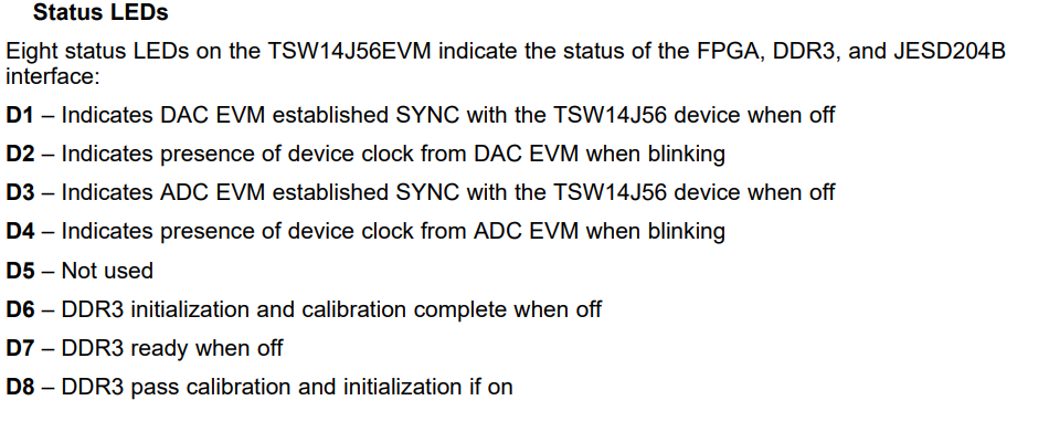

the ADS52J65 firmware (from the upper left).  This causes more initialization of the TSW14J56EVM FPGA.  In this process LED D8 briefly flickered ON, but is
ultimately off and LED's D7 and D6 are on.  I saw in some user forum that this alone is a sign of memory failure. LED
D3  is ON.  In attempting the first exercise of the ADS52J65 (80 MSPS, 4 lane, ADC - not ramp), and 32767 samples,
when I hit capture, D3 turns OFF, and D4 blinks ON/OFF.  Then after a timeout I get the error message for Read DDR to file.

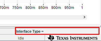

    3. Please make sure that you download the default “TSW14J56REVD_LMK_SYSREF_TRIGGER” Firmware is downloaded.
    You could verify this by making sure the Interface Type = “TSW14J56REVD_LMK_SYSREF_TRIGGER” in HSDC pro GUI
    1. You could also manually download firmware by (HSDC pro GUI >> Instrument Options >> Download Firmware >> select “TSW14J56REVD_LMK_SYSREF_TRIGGER”)

    3. Please refer to the image below for understanding on status LED.

    I am using a 5V power supply rated for 4 amperes, so power is not an issue. Both LED D17 (Vref good) and LED D10 (board power) are ON. I also verified a manual download of the interface type = TSW14J56REVD_LMK_SYSREF_TRIGGER The symptoms persist. LED D8 is off (MEM FAIL), LED D7 (MEM Success) is ON, and LED D6 (MEM init) is ON. When I hit capture LED D3 goes off, and LED D4 starts blinking. D8 remains off, and D6, D7 are on.  I will get the "Read DDR to File Timed Out Error"
  • Greig,
    Based on the below LED status,
    1. D8 (MEM Fail) – OFF
    2. D7 (MEM Success) – ON
    3. D6 (MEM Init) – On
    It seems like there is some problem with TS14J56EVM DDR since the calibration is failing.
    Please contact TI customer service for a replacement TSW board. Let me know if they require any other information from us to get you a new board.
