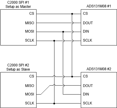

Hi expert,
I am completing a Design using one C2000 two SPI module connecting two ADS131. two ADS131 are clocking by one external 8M crystal.
I test every single ADS131 can work normally. And I want to enable it in the same code.
So I edit the hal.c / hal.h / ads131m0x.c , but I found it can not work together, which means I can not see the SCLK between C2000 and ADS131.
When I change the sequence of these code in main.c, I can see ADS131-1 SCLK and ADS131-2 SCLK, but not at same time.

I almost copied the driver code for every function I used. But not for these
static uint16_t             registerMap[NUM_REGISTERS];
void restoreRegisterDefaults(void)
Because I suppose it should be the same for each ADS131, but I can tell which one by call different SPI module to write.
Could you kindly tell me where I did wrong?

  • Emma,
    This type of question really should go to the C2000 support forum. You'll need to check with them to see if the C2000 can handle two independent SPI ports at the same time. We're not sure if it can be run this way.
    However, we did come up with a different way of reading out two different devices at the same time (thanks Tom Hendrick and Chris Hall) if you want to try it. For the C2000, you would run one SPI port as a master, and then the other SPI port as a slave. A setup diagram is shown below:
    First the SPI master drives the /CS, SCLK and DIN for all ADS131M08s and the SPI slave. This would control all devices the same way. The SPI master would also read ADS131M08 #1. SPI port #2 would then be used only to read ADS131M08 #2.
    Again, you should ask the C2000 forum about using both SPI ports simultaneously. If that doesn't work, you can ask them about this method. Do you need help moving this post to the other forum?
    Joseph Wu
  • Joseph,
    please help to move the thread to C2000 forum. thanks!
    BR
    Emma
    I work in the C2000 applications team and can comment.  The best approach to get the to ADCs perfectly synchronized is going to be the HW solution suggested by Joseph.  With this approach the C2000 SPIA module (for example) acts as master and controls the two ADCs and the second C2000 SPIB module (for example) setup as slave.
    One more thing, I took a look at your readDataTx() function in your code and I noticed you do multiple writes to the TXBUF register.  However, I didn't see if you were enabling the TX FIFO anywhere else in your code.  Without the FIFO enabled you may just end up overwriting the data in the TXBUF before it gets shifted out and some data may not get shifted out.  One option is to enable the FIFO or to use the SPI_writeDataBlockingNonFIFO() function which will force the CPU to wait for the TXBUF to be empty before writing data to it.
