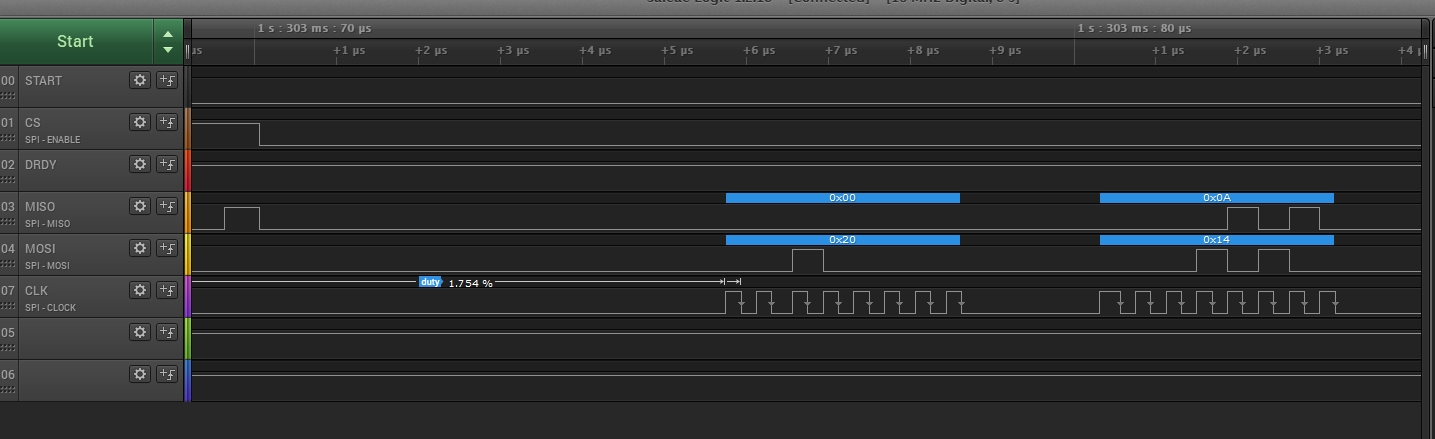

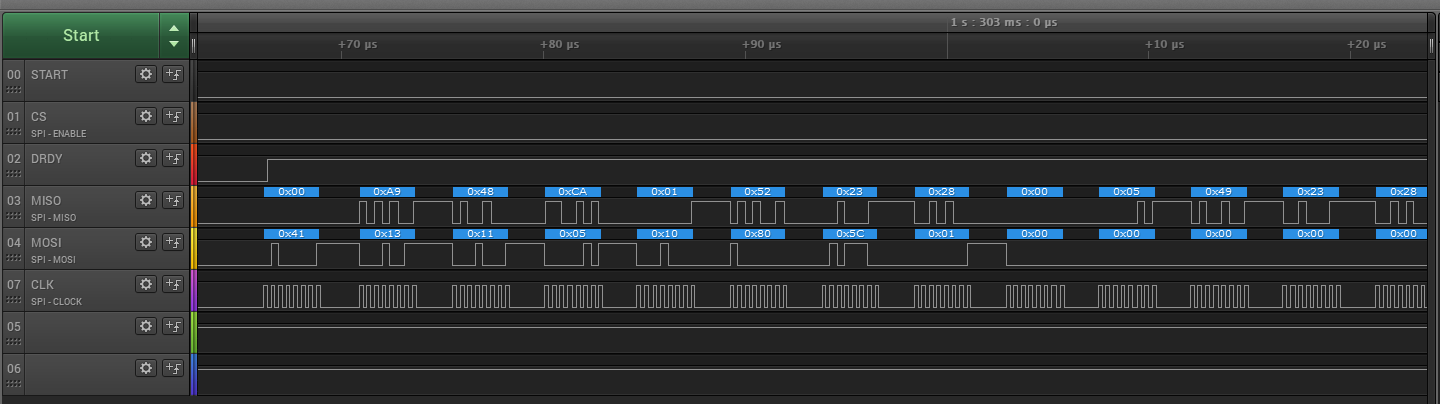

This is a screenshot of my signal:
In detail, we can see the write command (0x41 from MOSI) and some regvalus, in particular:
POWER1 : 0x11
Interface: 0x05
Mode0: 0x10
Mode1: 0x80
Mode2: 0x5c ...

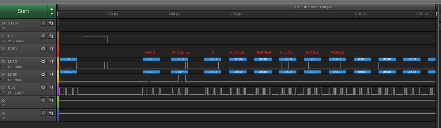

Well, after CS HIGH, I start reading but values are wrong:
In detail:
Sometimes values are "better", other times are completly wrong.

What seems me strange is DRDY, that is HIGH all time long , but how  can I put it LOW? Isn't it an output?
Thanks and best regarts,
Mario

  • Hi Mario,
    Your polarity and phase configurations for SPI interface are correct, also I do not see an obvious error in your program and timing. To address the issue, can you please do the experiments below step by step?
    1. Disable register writing subroutine, just read default value of few registers after power up the device, for example, only read one or two internal registers, then check if the retrieved data is correct.
    2. If the data of registers on MISO is correct, then expand to read all 21 registers you want.
    3. If the retrieved data for all registers are correct, write few registers, then read them back to check.
    4. Expand to write and read all registers(write 20 registers and read 21 registers as you want in your program), then check if all retrieved data are correct.
    I'm looking forward to seeing your experiment result.
    Regarding your last question, the /DRDY is an output signal which is data ready indicator(active low). Since you are not doing conversion by either the START or by serial commands, so the /DRDY signal will be always in high state. You can leave this /DRDY pin unconnected if it is unused.
