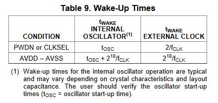

I’m trying to get some clarity on the power up timing for the ADS1158.
The datasheet sort of shows that a reset, whether with AVDD-AVSS or RESET command or pin, requires oscillator wake time + PLL lock time + 2^18 fclk cycles and taking PWDN pin high requires just the oscillator wake time + PLL lock time. This would give:
2^18*(1/15.729 MHz) = 16.6 ms for just the reset function but would still require the oscillator wake time and PLL lock time before the device is ready for any communication from the MCU. Is that correct?
How would one determine the PLL lock time?
