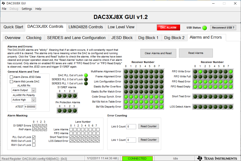

### With both settings, SYNC is low.
I have checked it with D3 LED, that is connected sync_led output from FPGA.
And, I also checked it with ALARM test point and dtest setting(0100, SYNC, config27)

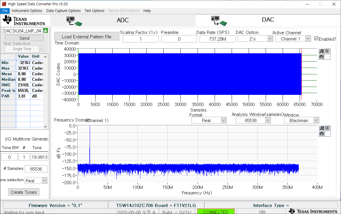

### ZCU106_2P setting stuck at “WriteDrpReg()” function when send data.
ZCU106_4P setting doesn’t stuck at WriteDrpReg function when send data.
I have attached debug messages from microblaze firmware for both settings.

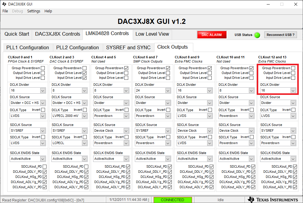

Belowes are Quick Start, LM04828 Clock Outputs setting, and Alarms after sending data from HSDC pro, for ZCU106_2P setting.
Belowes are Quick Start, LM04828 Clock Outputs setting, and Alarms after sending data from HSDC pro, for ZCU106_4P.
Clock Outpus Setting is same with ZCU106_2P.
I have also attached debug messages from microblaze firmware.
I have analyzed those messages, but cannot find cause of the problems.
Please, check my modifications and GUI settings.

Jesd204Status   = 0x00
DataBlockStatus = 0x22
PHY PLL Status  = 0x1D
