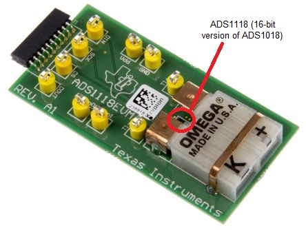

    As an example, the ADS1118 (the 16-bit version of the ADS1018) is used in a thermocouple demonstration. For that application, the device is placed between the thermocouple contacts so that it can best measure the temperature there. For thermocouple applications, this measurement is critical, and it looks like this on the board:
    However, a thermocouple application won't have the same requirements as a power transistor temperature measurement. The thermocouple measurement itself doesn't have any heat associated with it and the temperature is likely near ambient as long as there isn't much circuitry near the device.
    For your application, I'm not sure how accurate you need to measure the temperature and how close it is to the device. In most power device applications, like this, I've seen a temperature sensor place between two power devices so that the temperature is closer to that seen in each of the devices.
