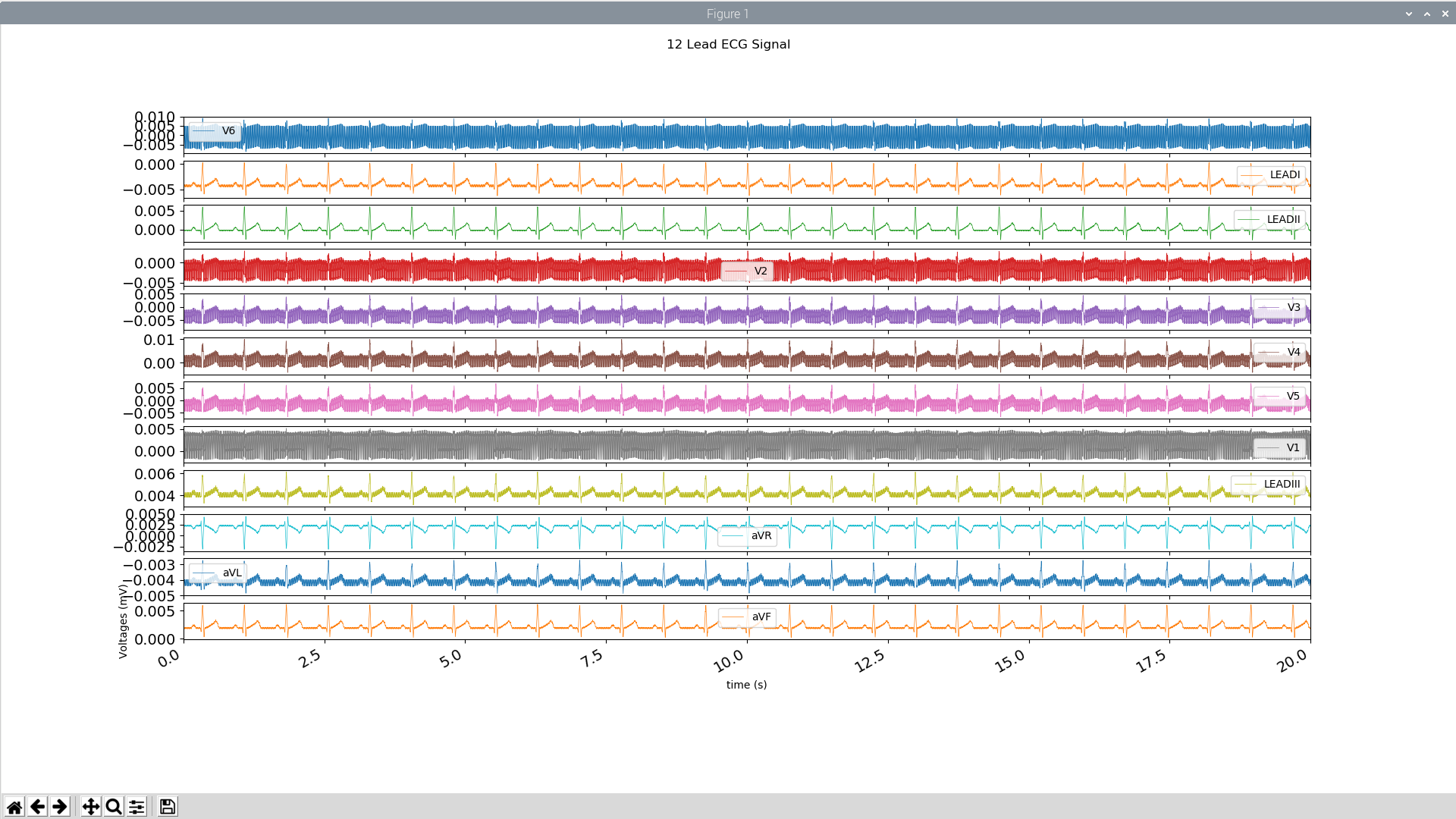

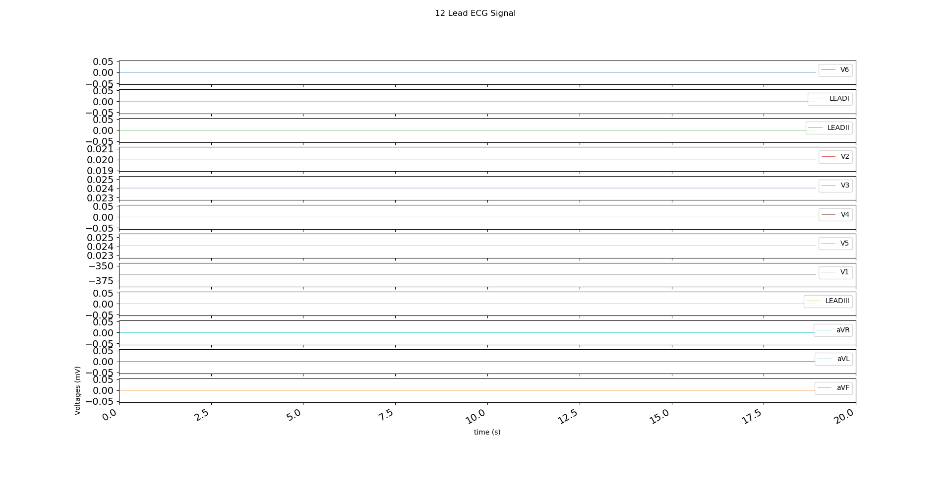

I'm currently using ADS1298R and Raspberry Pi 4, and having a trouble in using it in 1K SPS.
I already used clock divider 128 and 256.
I am confused in determining the best clock divider.
Sometimes, I got satisfied result.
After the good result, I don't get the good result again.
Why the results like these are happening? Am I doing something wrong? Should I send my code here?

    I want to acquire ECG signal 12-lead from all channels using freq. samp 1K SPS in 20 seconds.
    How can I get exactly 20,000 data?
    Is there a clock divider effect of the excess or shortage of data obtained?
    Can you suggest what clock divider suits my needs?

  • Hi William,
    Ah, I think I understand better now.
    The nominal frequency for an external clock is 2.048MHz.
    The modulator samples the input signal at the rate of fMOD = fCLK / 4 for high-resolution (HR) mode and fMOD = fCLK / 8 for low-power (LP) mode.
    Then the decimation ratio, DR[2:0] in the CONFIG1 register sets the sample rate.
    000: fMOD / 16 (HR Mode: 32 kSPS, LP Mode: 16 kSPS)
    001: fMOD / 32 (HR Mode: 16 kSPS, LP Mode: 8 kSPS)
    010: fMOD / 64 (HR Mode: 8 kSPS, LP Mode: 4 kSPS)
    011: fMOD / 128 (HR Mode: 4 kSPS, LP Mode: 2 kSPS)
    100: fMOD / 256 (HR Mode: 2 kSPS, LP Mode: 1 kSPS)
    101: fMOD / 512 (HR Mode: 1 kSPS, LP Mode: 500 SPS)
    110: fMOD / 1024 (HR Mode: 500 SPS, LP Mode: 250 SPS)
    Knowing the relationship between the clock, modulator, and resulting sample frequency depending on your sample mode should help you calculate the clock frequency you need.
