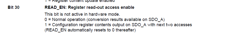

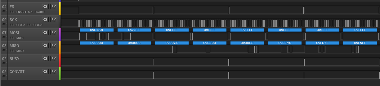

I am trying to read data from an ADS8528 using SPI. Using my logic analyzer, I can see activity on the MISO pin in response to what I am sending but I am unable to make sense of the data.
I have tried to read the config register back by setting bit 30 high and then initiating a read but that doesn't give the value that I just wrote to the config register as I would expect.
I think I would expect the values after the first two CONVST/BUSY cycles to be the Config register based on setting Bit 30 high. I then would expect the third (and ensuing) reads to be A/D values. Does that sound right?

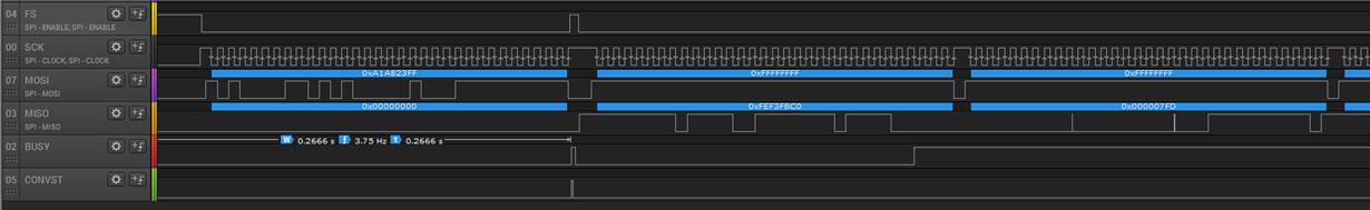

    When I try to just read data (instead of trying to read the config register first), the BUSY bit always goes back high in the middle of reading the 4th word. See picture below. I switched to 32-bit reads/writes to see if that would make a difference.
    I can't find anything about that in the datasheet. Maybe it is a clue to what I am doing wrong?

    1) I found here, that I needed to be sending 0x00's instead of 0xFF's when I was reading values. This resolved the issue where the BUSY bit was going back high. I've always thought 0xFF's was the standard and didn't realize that was a problem.
