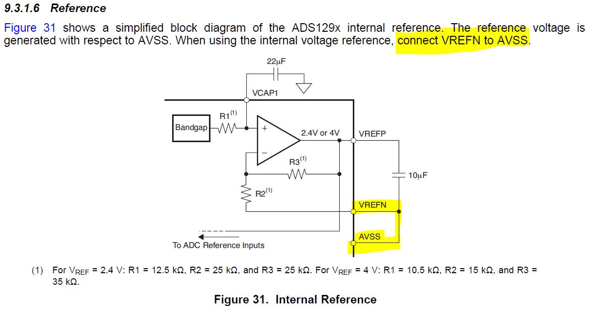

I am looking at ways of reducing the noise on my ADS1298 implementation.
Board is configured with decoupling capacitors as per datasheet but I am getting a RMS Noise of between 50 and 100µV when I place the device in High Resolution Mode DR Bits 010 (8000 SPS).
The data sheet Table 1. indicates that a level of 12.4µV ought to be possible. Any idea on areas I can improve?
In my configuration I am using bipolar supplies (±2.5V). I see that VCAP1 which decouples the reference voltage ought to be connected to Vss. If this is the case then don't I lose the PSRR of the device since noise will be coupled in from the power rail straight onto the reference voltage? Wouldn't I be better to connect to GND ?
Are there recommendations on the ESR of the capacitors that I should be using?

    VCAP1 is the bandgap voltage used to generate the reference voltage. When the ADCs sample, they compare the differential input to the differential reference voltage (REFP - REFN). REFN should also be connected to AVSS, so VCAP1 should be decoupled to AVSS as well.

    You are suggesting that REFN ought to be connected to AVSS (-2.5V in my system) ?

    Yes, REFN must be connected to -2.5 V. Please refer to Figure 31 in the data sheet.
    I realize that this figure shows VCAP1 decoupled to ground. Technically, we want all four VCAPx pins to be decoupled to AVSS.

    I misunderstood what you meant by reference - I thought that you were talking about the negative part of each Analog Input. These I have connected to GND.
    My VREFN is connected as per Fig 107 in data sheet with a 10µF and 100nF capacitors to VREFP and direction connection to AVSS.
