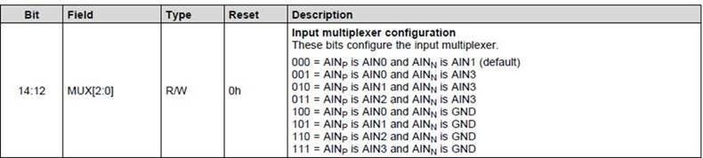

As per the datasheet to fetch conversion result for respective channels we need to send configuration command by setting bit 14:12 bits for respective channels, i.e. to get AIN1 channel result send config command with bit 14:12 - 101 and so on.
  1. On power up we will be sending configuration command for initializing device for expected settings , is it ok to send configuration command every time to get data from conversion register?
  2. As per data sheet once configuration command is received AD1018 will start conversion and result will be ready after 1/SPS interval. In case of single shot conversion how is behaviour ?  For fetching conversion result in case of single shot mode , do we need to send 2 commands? First for setting configuration and then  for fetching result?
  3. Once initialization is done with first configuration command , subsequent config command of respective channels are for initiating conversion for respective channels ? or its for fetching respective channel’s converted result?

    1. Yes, you can send a configuration command every time to get data from the conversion register, this is described as the 32-bit data transmission cycle described on page 18 of the datasheet in section 8.5.7.1. Here you configure the device with a write to the configuration register, but are reading back the data after the completion of the last conversion.
    2. Single-shot conversion is basically the same, you would write the next configuration to start it after the last conversion completes. I highly recommend using single-shot conversion mode when there are multiple channels. When using the device in continuous conversion mode, a write to the configuration register does not get executed until after the conversion in progress completes. This can cause problems for the user because the conversion may not start when it is expected.
    3. For each channel, you need to configure the device to get the data to convert and then retrieve the data for that channel. There is not auto-cycling of the device. You program it to take data for a particular channel, then read the data and program the device for the next channel.
    Now this is the sequence I would use:
    1. Start with the 32-bit data transmission cycle with configuration register read back. This is used to start conversions and read back the previous conversion data.
    2. The master waits for the conversion to complete. . This wait time is the nominal data
    period plus 10% (to compensate for the internal oscillator variation of the device). . An additional 20µs is added for the wakeup time of the ADC for each single-shot conversion.
    Total wait time = nominal data period + 10% + 20µs
    3. Go to 1 to configure the next setting and read back the ADC from the setting of 2.
