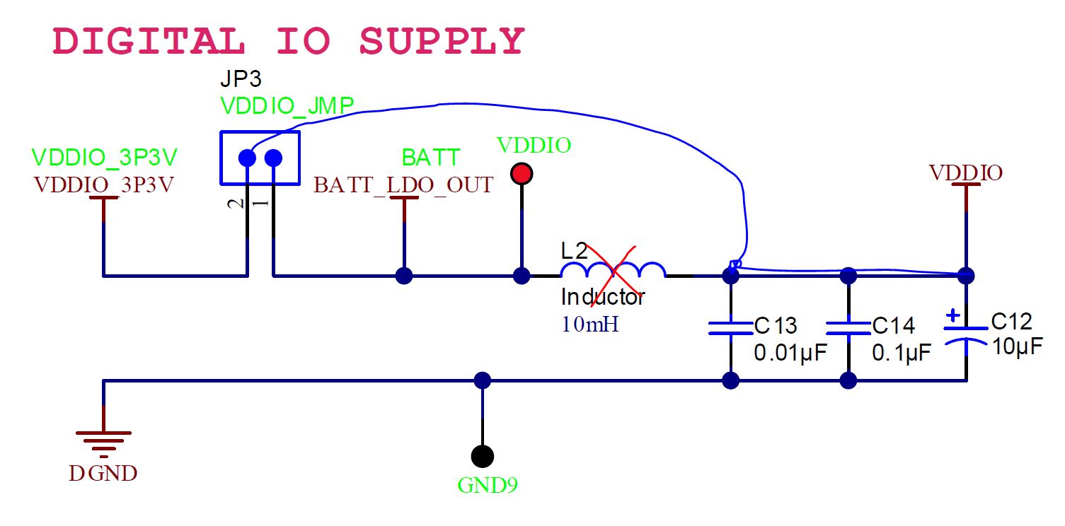

    1. I would like to use the same power supply for my preamplifier and the analog components of the ADS1293. Since I would like to visualize my signals using the ADS1293 software, would it be possible to use a battery for analog power supply (VDD) and the USB connection as the digital power supply (VDDIO)? Based on the schematics in pages 10-12 of the ADS1293EVM User Guide, this does not seem possible since JP3 shorts the VDDIO_3P3V and the BATT_LDO_OUT terminals.

    1. You are correct, but you could make it work with some modifications. If you uninstalled the inductor, L2, you could jump a wire from JP3[2] to the top of C12/13/14.
