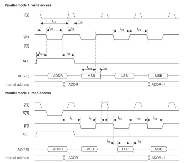

    The AMC1210 has the following parallel interface:
    nCS Chip Select
    nALE Adress/Data Select - Is high when AD0-7 represent an address, and low when AD0-7 carry data
    nRD Read
    nWR Write
    AD0-7 Databus 0-7 - Shared bus for data and address
    Here my thoughts on the connection to the EMIF signals:
    nCS Is connected to CS2 of EMIF1
    nALE Is connected to A0.
    nRD Is connected to nOE of EMIF1
    nWR Is connected to nWE to EMIF1
    AD0-7 Is connected to D0 - D7 of EMIF1
    The software driver for the AMC1210 will address two different addresses (e.g. 0x0010 0000 and 0x0010 0001). This allows to switch between address and data interpretation via the LSB of the address bus. Further by writing to this address space, the nCS signal is automatically set by the EMIF controller.
    This is my actual state of knowledge. Do you see any problems?
    Look like it is expecting address and data on same bus which is not the case with EMIF. EMIF has different data and address lines hence no ALE signal. It may not work without some glue logic which can mux address and data from EMIF. Is there any other interface like SPI which can be used in this case?

  • Okay, it took some time to check all the timing requirements. The SPI is no alternative, as it is much too slow. I think I can use the parallel interface with some modifications.
    Like I wrote previously, I will do the following connections:
    nALE Is connected to A[0] of EMIF1
    AD0-7 Is connected to D[0 - 7] of EMIF1
    I checked the timing for the EMIF1 and the AMC1210 and the timing requirements can be met. The nALE signal will be generated by the EMIF1 controller by writing to two different addresses:
    • Address number 1 is an even address, so EMIF1A[0] is low
    • Address number 2 is an odd address, so EMIF1A[0] is high.
    When the address should be written to the AMC1210, adress number 2 is used. When the data should be written or read the address number 1 is used.
    Timing diagramm for parallel mode 1 of AMC1210
    The only question is, if it is a problem for the AMC1210 when the nALE signal is in tristate between two accesses? I think the EMIF1 controller will put the address bus back to tristate after a memory access is finished?
  • Hi Michael,
    Very nice idea.
    On below query -
    Address bus does not get tristate. It is always output unless device gets reset.
