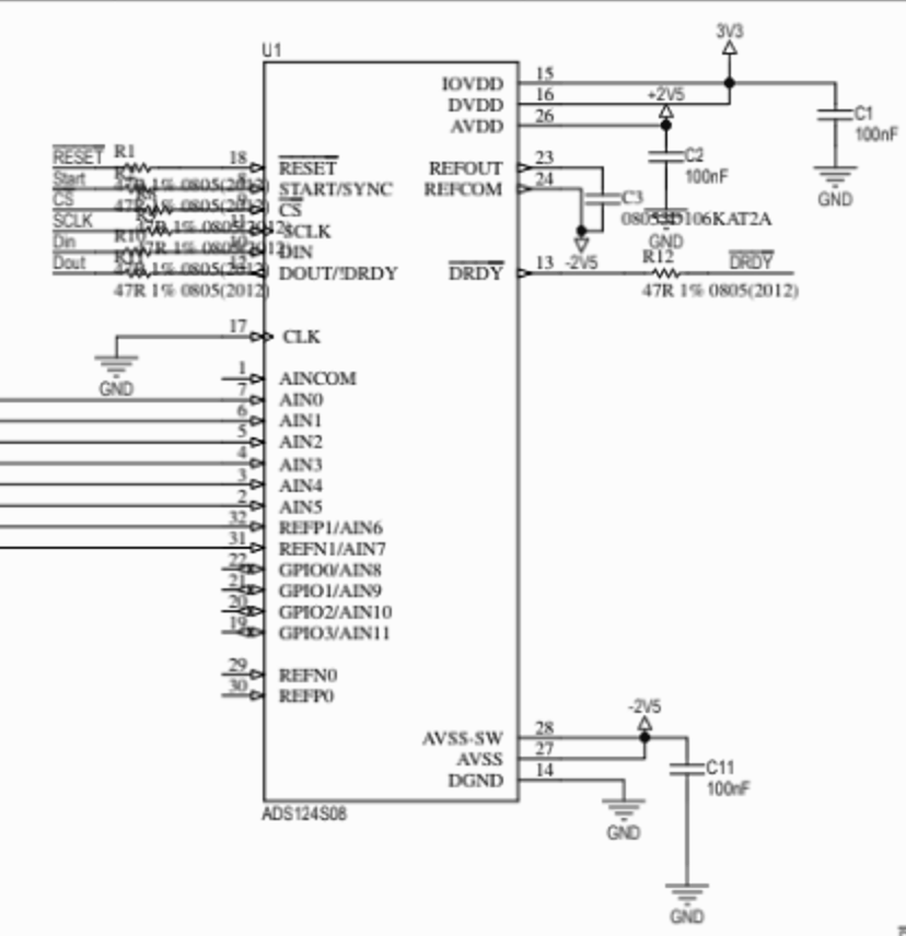

This is our actual HW connection:

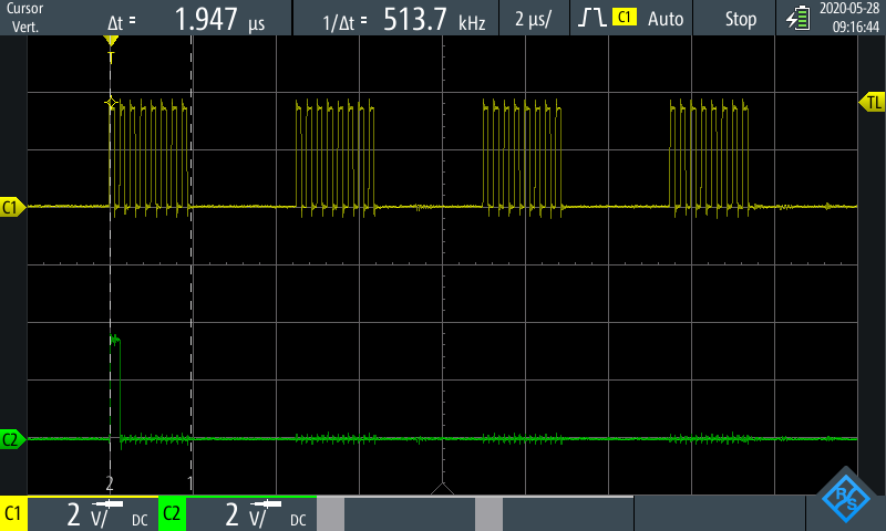

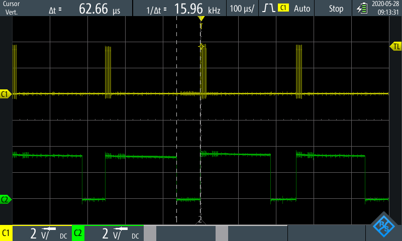

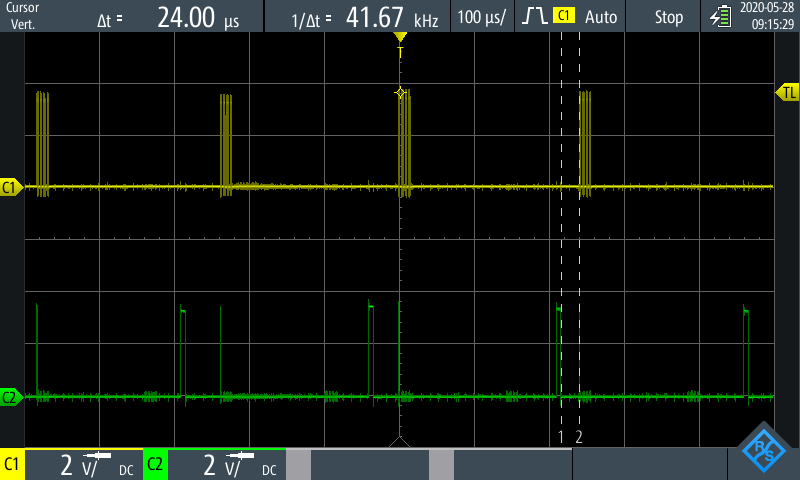

These are some pictures of DRDY, SCLK and DOUT signals:
- DRDY signal and SCLK
- SCLK and DOUT
- SCLK and DOUT with zoom

Please could you tell me if the configuration is correct and if I do something wrong? Because I read always 0.

    One other thing I noticed in the schematic is you are missing the required 330nF cap between AVDD and AVSS.

    thank you very much for the quick answer, I did not realized about FSCAL register. About the schematic you are right this is something we need to check. I will let you know if with this change I can read properly the values.
