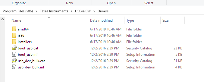

    From the next pop-up 'Browse for drivers on my computer, select the 'Browse' button and browse to location shown below:
    After the proper location is in the Browse window, select Next.  The proper selection is the usb_dev_bulk.inf file.
