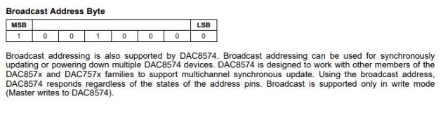

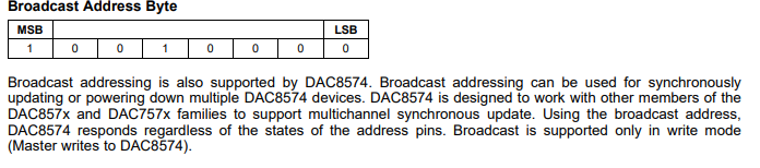

  • Hi Mou,
    You should note that all DAC8574s will ACK to the 0x48 because that is the BROADCAST address.  Broadcast mode is a specific function built into some DACs that allows you to update all DACs at the same time.  This good for shutdown events.
    What is possibly happening in your system is that only one device is correctly powered on or configured, the 0x4C device.

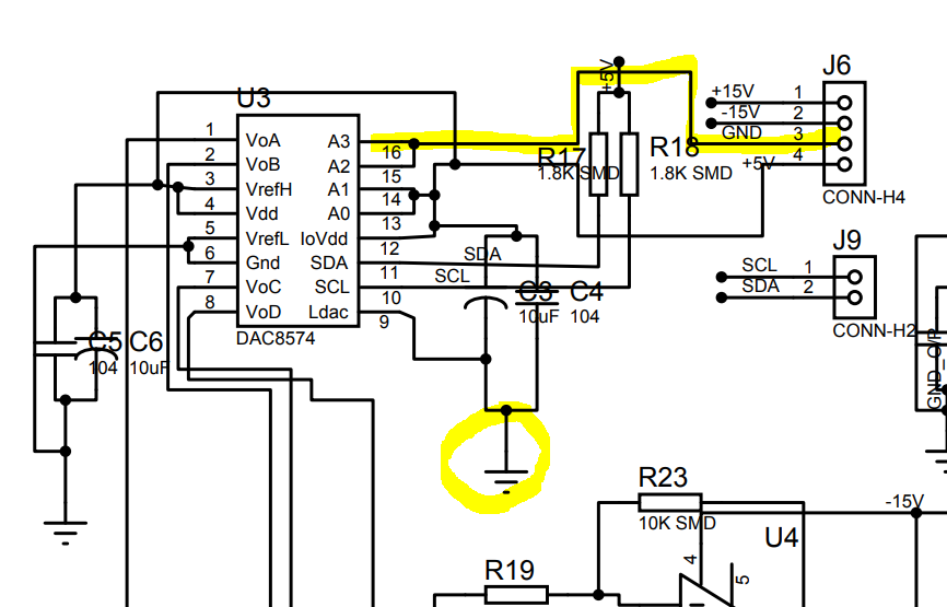

    Can you share the DAC portion of your schematic?

    Meanwhile You can have a look at the schematic of the DAC part. DAC part.pdf
  • Hi Mou,
    Could this be a grounding issue? I see that you have this J6 connector that is only connected to a net name called "GND", but I do not see where that is connected to the ground symbol.  I have seen this be a problem in certain schematic capture programs.  You should look at your layout and confirm that the gnd nets are actually connected.
    You also have two sets of pull up resistors for the I2C lines.  These are in parallel so you have 900Ω pullups, which is quite small.  Are you I2C lines able to drive that load?
    Paul
  • Hi Paul
    Thanks for the suggestion. I have checked the Gnd connections. It is well connected to Gnd terminal.

  • Hi Mou,
    I mentioned in a previous post: You should note that all DAC8574s will ACK to the 0x48 because that is the BROADCAST address.  Broadcast mode is a specific function built into some DACs that allows you to update all DACs at the same time.  This good for shutdown events.
    Address 0x48 will be discoverable in any system with the DAC8574.
