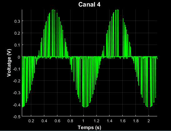

I'm working in a project and I'm using the ADS1299 connected to microcontroller STM32WB55.Data is acquired with the ADS1299, this data is sent to the micrcontroller through the SPI bus and then, the micrcontroller sends the data through UART bus to a computer. To test the ADS1299 I use a 300 mV 10Hz sinusoidal wave, before getting data from an electrode. The problem is that when capturing data there are some data whose values are not the correct values, and the rest of data have the correct value. As a result, when I print the acquired data results like the image below:

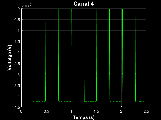

In addition, when I use the internal test signal of the ADS1299 the acquired data seems to be also OK.

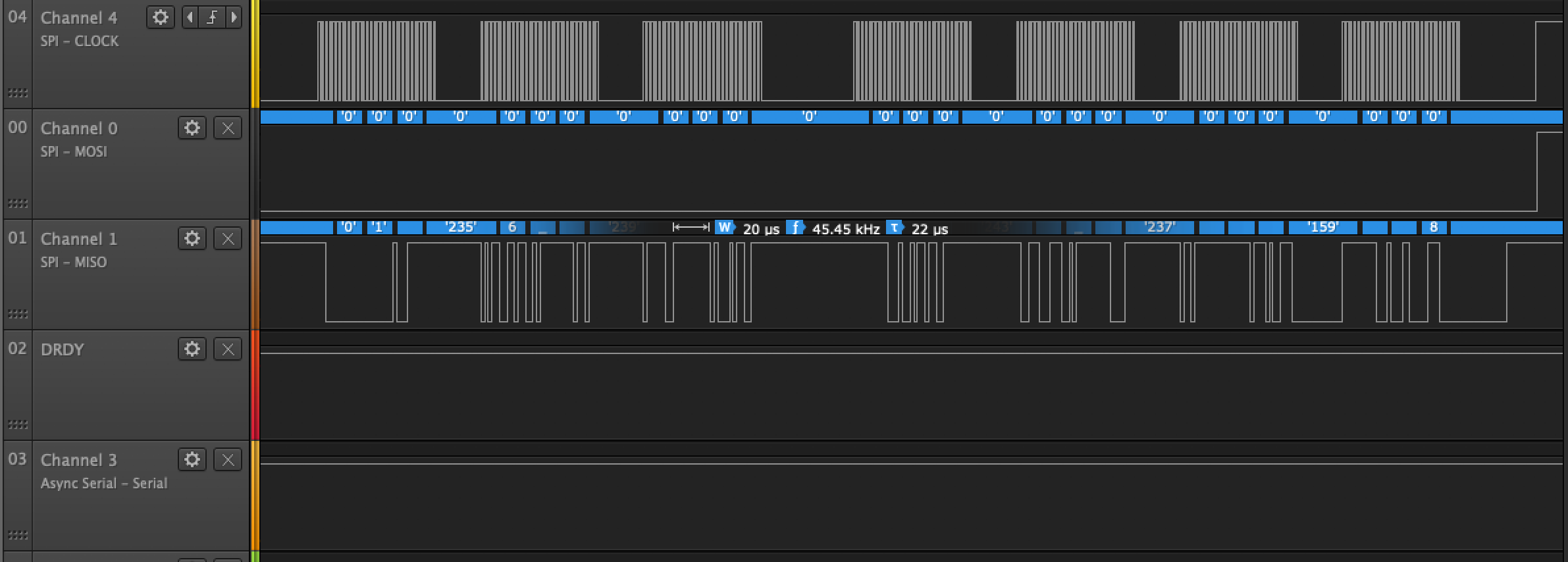

I also have checked the SPI communication with a logic analyzer and the communication seems to be OK, so I don't know if the problem comes from the communication or from the data acquisition. Here is a screenshoot of the SPI communication. The UART bus works perfectly. It has been tested independently.
