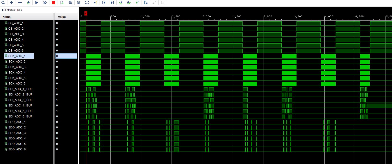

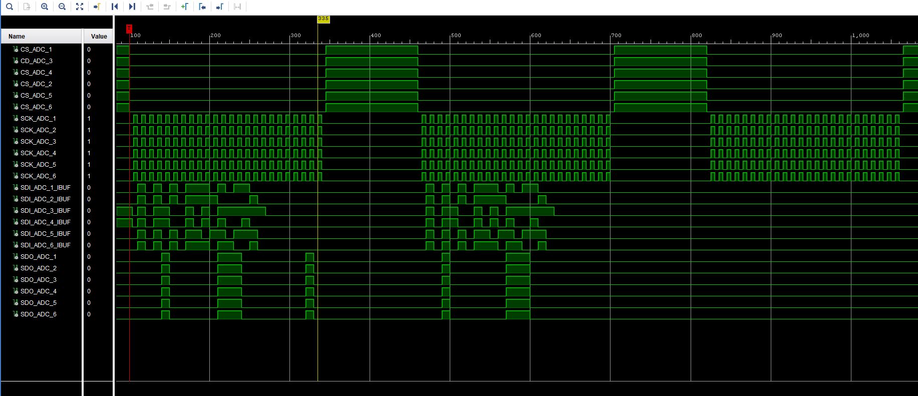

  • Hi Keith,
    Here is a capture of the data from all 6 ADCs simultanesouly
    The transactions are:
        --  WRITE DEVICE_CFG Addr = 0x1C Data = 0x02
        --  0x08_1C_02
        --  READ DEVICE_CFG Addr = 0x1C Data = 0x00
        --  0x10_1C_00
        --  WRITE AUTO SEQ CFG1 Addr = 0x80 Data = 0xFF
        --  0x08_80_FF
        --  READ AUTO SEQ CFG1 Addr = 0x80 Data = 0x00
        --  0x10_80_00
        --  WRITE AUTO SEQ CFG2 Addr = 0x82 Data = 0x01
        --  0x08_82_01
        --  READ AUTO SEQ CFG2 Addr = 0x82 Data = 0x00
        --  0x10_82_00
        --  WRITE SEQ_START Addr = 0x1E Data = 0x01
        --  0x08_1E_01
    The data received from the read to 0x1C is 0x00 (Should be 0x02)
    The data received from the read to 0x80 is 0xFF (Default Value)
    The data received from the read to 0x82 is 0x00 (Should be 0x01)

  • Hi Keith,
    This is from another run, so there's an extra transaction of all 0 after the read, but the behavior is identical
    --Write (0x08_1C02)
    --Read (0x10_1C00)
    --Finish Read (0x00_0000) All 0s received
    SCLK is running at 25 MHz, this data is be captured with Vivado Chipscope at 250MHz
    Sean
  • Hi Sean,
    I do not see anything wrong with the waveforms that you provided.
    Can you confirm and measure the voltage on DVDD?  Double check the voltages on AVDD and DECAP as well.
    Also, please confirm that the IO voltages are at the correct level.  If possible, an oscilloscope capture of /CS, SCLK, SDI, SDO for one of the ADC's may reveal what is going on.

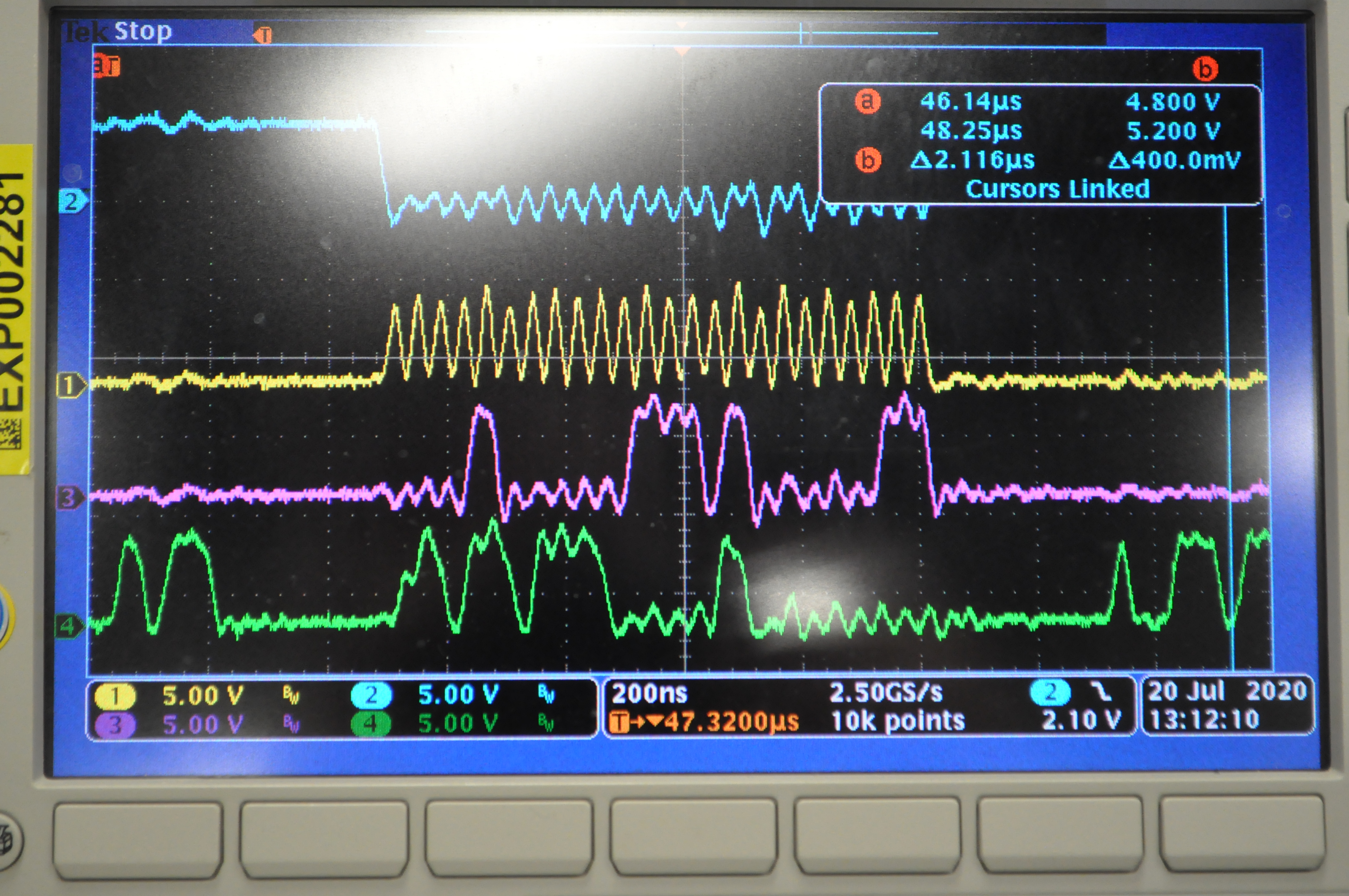

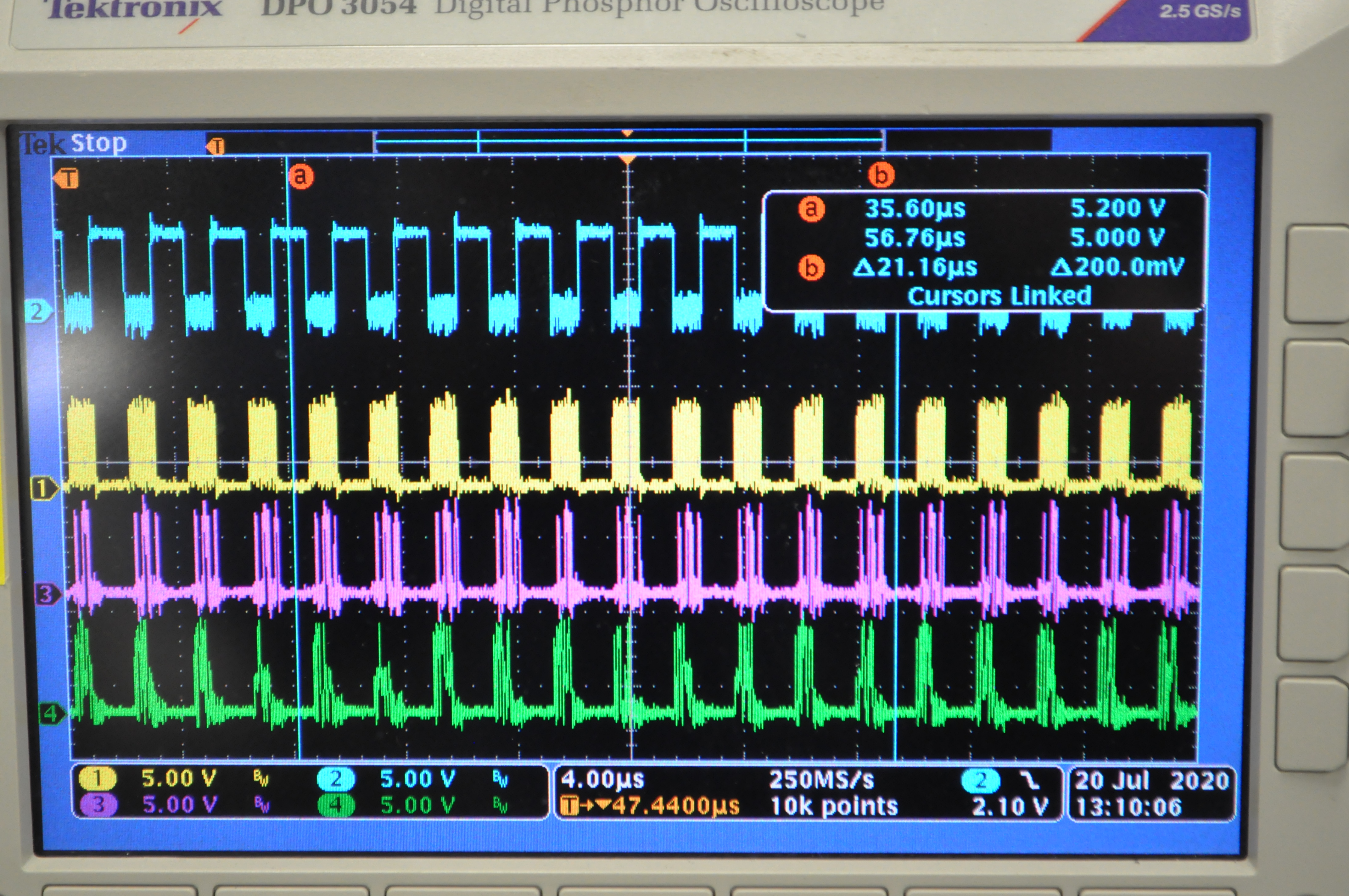

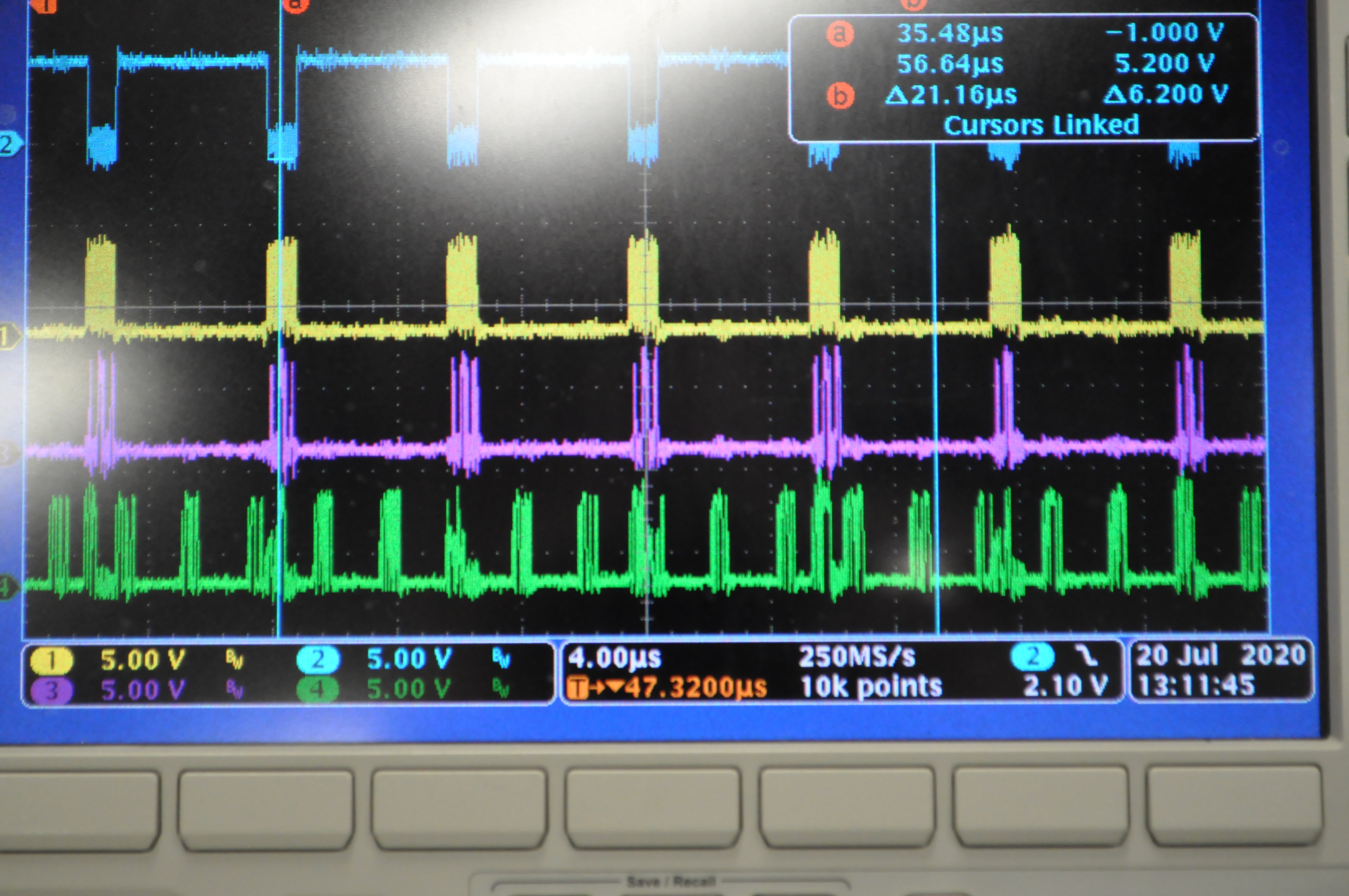

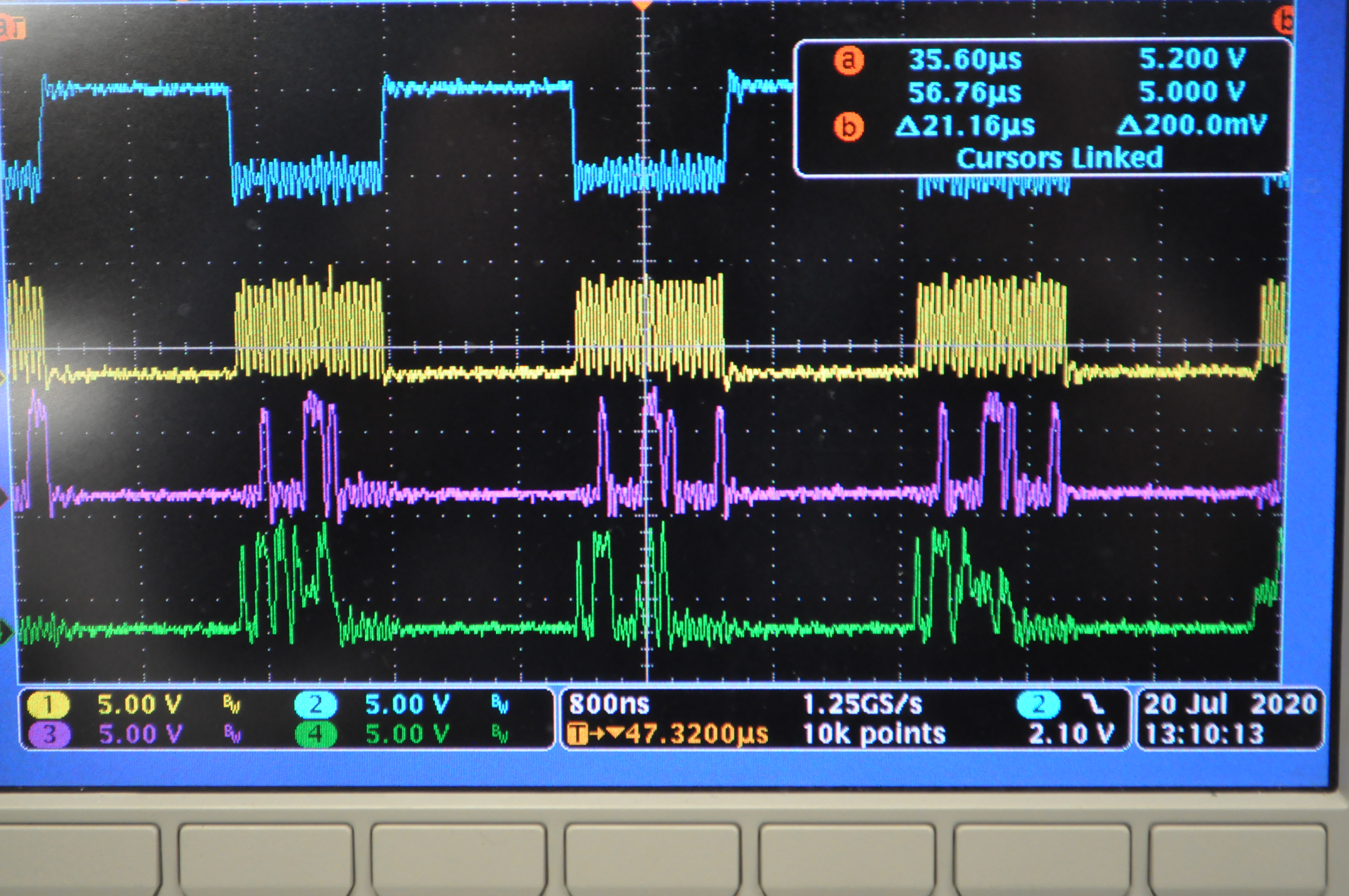

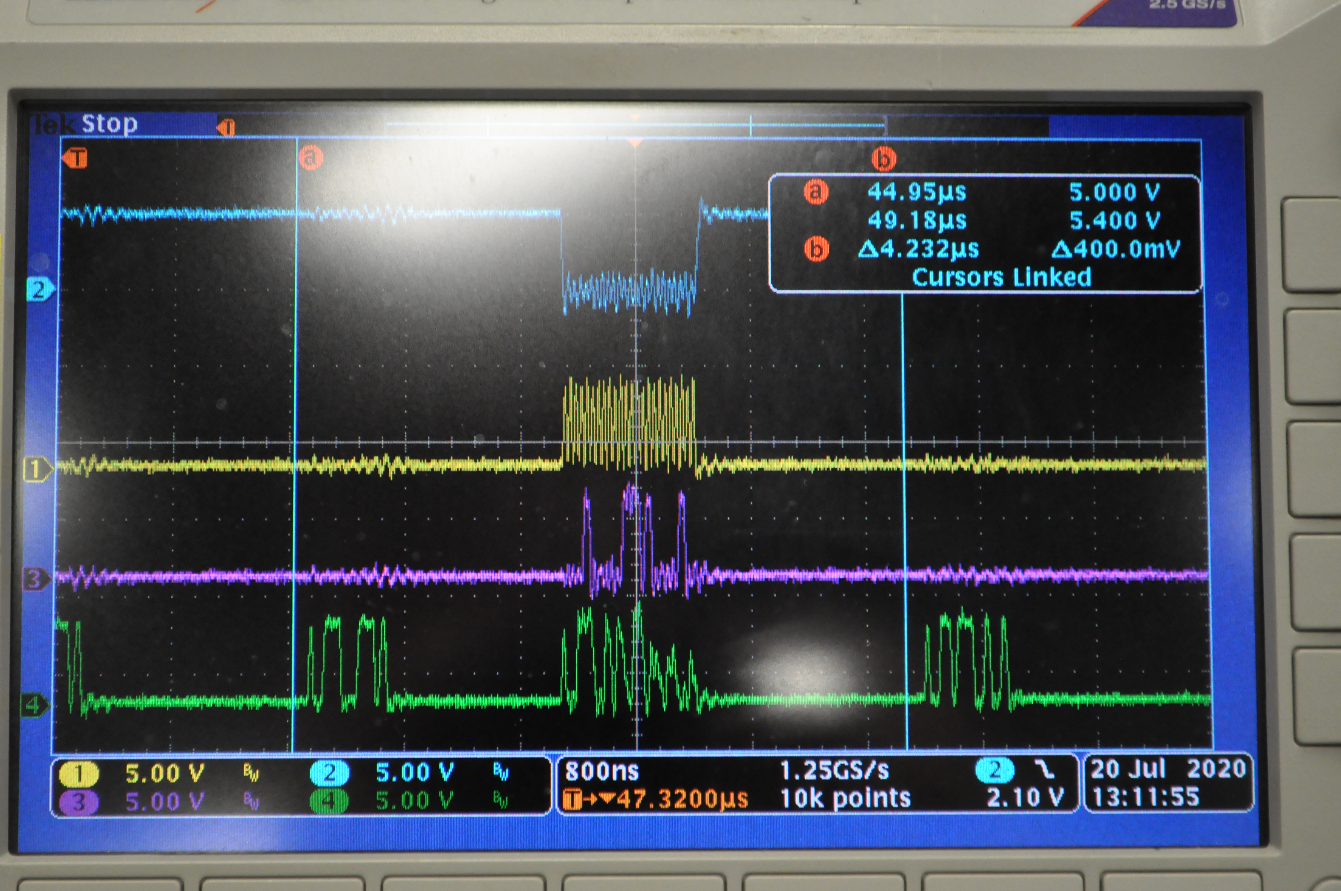

  • Hi Keith,
    Finally got some pictures of the Scope
    Top is Chip select
    2nd is clock
    3rd is mosi
    4th is miso
    The first one is nominal running the initial sequence, After the level shifter from 1.8V I/O to 5V I/O
    The Second one is zoomed in
    The third one is after changing the delay
    The fourth and all following are zoomed in after changing the delay
  • Hi Keith,
    As a follow up to my responses yesterday, we pulled the MISO signal from the ADC off of the level shifter and the signal immediately cleaned up and stopped sending anything in the middle of the chip being inactive.
    It also stopped reaching ~1/2 range of the 5V as seen in the pictures from before.
    We attempted to add on a pull down and a series resistance between the ADC and the level shifter but that has not fixed the problem.
    We are using the SN74LVCH16T245DL from B -> A shifting down from 5V to 1.8V both the output enable pins and directions pins are grounded.
    We are using the same part from B->A to shift up from 1.8V to 5V with no issue on that side similarly the enable pins and direction pins are grounded as well.
    Sean
