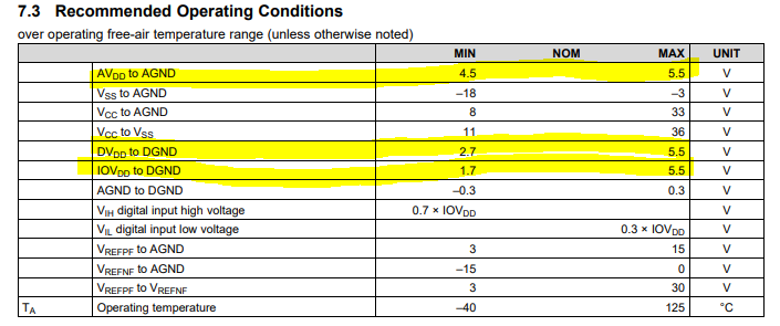

I developed a PCB with DAC11001A but with my uC TM4C1294 I cannot load the data.
In what order should you put CLR / and LDAC with the SPI port.
cordially
Wiotte Fabrice
My Programm : VREF + =+10V and VREF- = 0V POWER SUPLLY : VCC = +24V and VSS = 0V
ssi0PutData(0x02,0x004C80,0x03);  0x004C80 SDO enable - no alarm-DAC output update on SYNC - VREFVAL 10V -/+1.25v//
SysCtlDelay(2000);
PH1 = 0x00;  // LDAC
SysCtlDelay(100);
PH1 = 0x02;
ssi0PutData(0x01,0x000000,0x03);  //datas=0
SysCtlDelay(2000);
PH1 = 0x00;    // LDAC
SysCtlDelay(100);
PH1 = 0x02;
//SysCtlDelay(10000);
ssi0PutData(0x01,0x7FFFF0,0x03); //datas= middle code
SysCtlDelay(2000);
PH1 = 0x00;   // LDAC
SysCtlDelay(100);
PH1 = 0x02;
