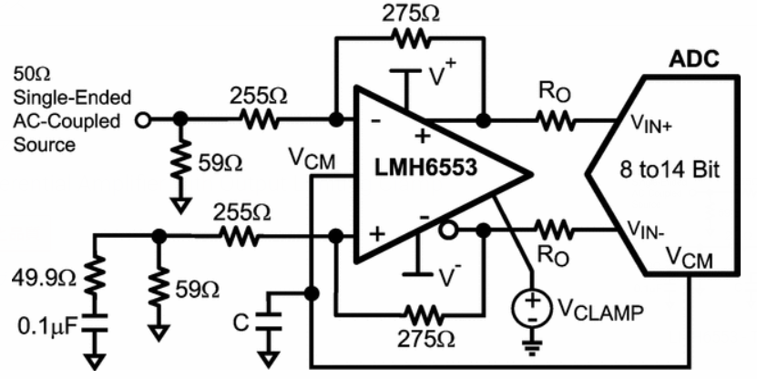

I'd like to check if there is any concern or design notice for ADS5407 analog input when it is combined with LMH6553?

Is there a requirement to be DC coupled at the input and therefore the output of the amplifier to the ADC?
Can you AC couple instead?
Rob
Hi Rob,
DC coupled is considered but AC coupled can be also acceptable depends on the benefits.
Thanks.
S.Sawamoto
Hi Sawanmoto,
If planning to AC couple this configuration, then simple put a series 0.1uF cap in-between the outputs of the amplifier and inputs of the ADC. You can also add a cap in series before the 59ohms to ground on the amplifier's input as well.
