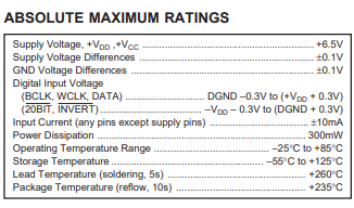

Hi, Is it possible to damage bit clock circuit/Data Latch Enable Input through pin2&7 by feeding high voltage through back when PCM1704 power supply is up to +20V by regulator issue?

It is definitely possible that you damaged the device. We publish the Absolute Maximum Ratings for this reason. The device is rated for a maximum of 6.5V based on the device physics of the process that was used to produce it, and the discrete components that are represented on the silicon. Applying greater than the absolute maximum can result in electrical over-stress (EOS).

I know that this DAC should have been damaged. However, I concern that if the clocker connected to the DAC was also damaged by the +20V stress. Do you have any ideal about this?

You would need to verify the abs. max values for the clock circuitry as well to see if you damaged it. I also recommend that you check all the pins to see if you have normal operation. You could also monitor the total current for each device to see if it is drawing too much.

Thanks. So it is possible that the 20V stress could feed back through PCM1704 to front-end clocker, right?

That can depend on many factors, such as how the 20V stress was applied in the first place. I think you should verify the behavior of all pins for the clock circuit and the DAC, to see if there is erroneous behavior.

Thanks. The +20V stress is directly applied to pin#6&11 of PCM1704 instead of +5V.

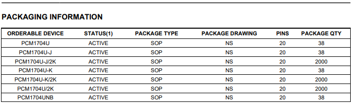

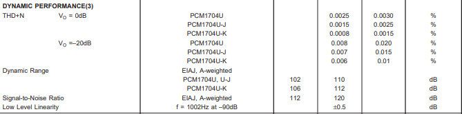

Hi Paul,
Any difference between PCM1704&PCM1704U? Can PCM1704 be replaced by PCM1704U directly?
Su
