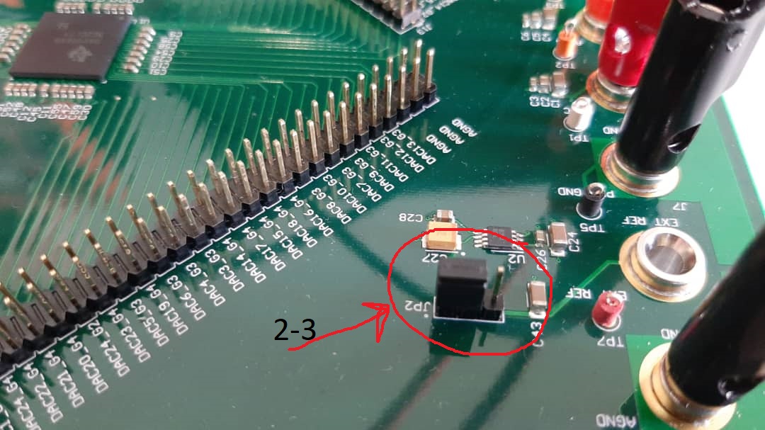

I recently bought a DAC60096EVM board. I followed all instructions in the user guide for DAC60096EVM and also SDM-USB-DIGPlatform but unfortunately, I could not get any output. All the procedures explain as below and I attached pictures from hardware and configuration:
  1. I updated the SDM-USB-DIG Platform driver suggested by TI technician in one of the forums.
  2. +12v and -12v are connected to the board.
  3. JP1 is configured on Pins 2-3.
  4. JP2 is configured on Pin 2-3.
  5. All GND connected to the ground.
But when I open GUI, it shows demo mode, and then when unchecked Demo from debug menu it shows hardware connected but no change on the board when you program it. D2 LED on the SDM-USB-DIG Platform is off the only D1 LED working. No output from any of pins when we configured the DAC.
Please let me know what is the issue? do we need any other configuration or connection?

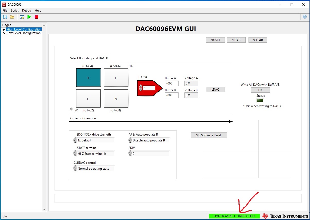

    After installed AMC7836EVM software and then connect the SDM-USB-DIG to the software LED turned on and also  AMC7836EVM software shows green connected.
    So what is your suggestion for SDM-USB-DIG works with DAC60096EVM GUI?

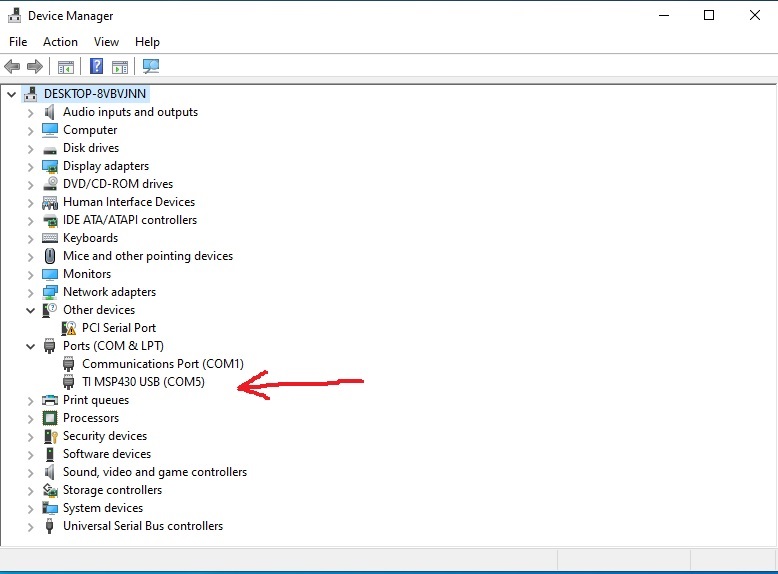

  • Hi Paul,

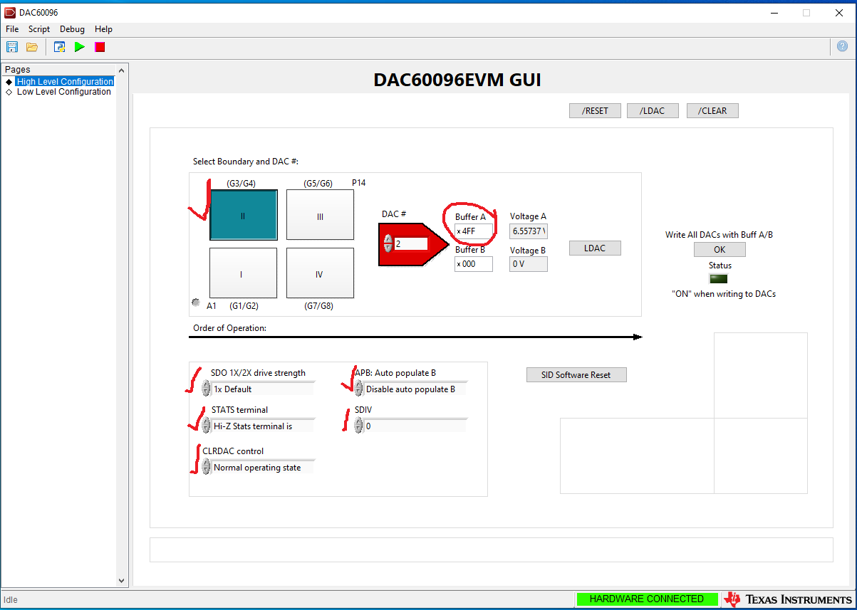

    I check again the DAC60096EVM GUI. After I installed AMC7836EVM software I didn't uninstall it just run DAC GUI and surprisingly it detect hardware without any issue and also LED goes on. Even I got output voltage from the board.
    Is it possible explain what kind of the driver AMC7836EVM software installed and why GUI software couldn't installed it?
    I have another problem, I try to use python script but GUI show me error "Pythone 2.7 not detected. Please install python 2.7 to use scripting". I already install python 2.7.18 with IDLE and its on windows path.
  • Hi Mahmood,
    Good to hear that the GUI is now working.  I will have to look into why the original had an issue installing the driver.  One thing that comes to mind is that the AMC7836EVM installer was recently re-compiled, so it might have better Windows 10 support (I assume that is what you are using).
