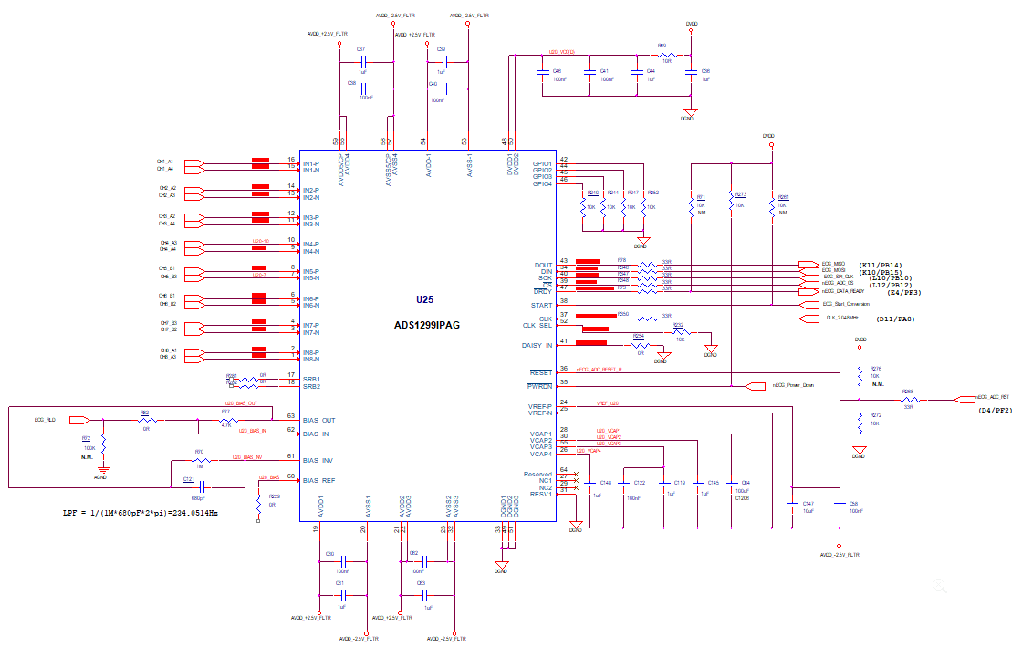

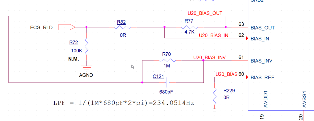

I need some technical assistance for the following issue. Using the part number ADS1299IPAG
I am observing un-wanted and un-intended pulses on the bio-potential channels and suspect that the root cause of these pulses is the RLD pin.
This occurs when all of the bio-pot channels (incl RLD) are open, meaning not attached to the skin or any input resistance, but rather "open" or "in the air"
(And they do not occur once bio-pot electrodes are attached to skin).

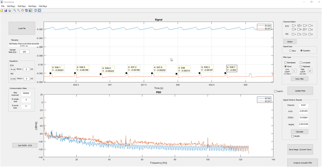

the pulses observed are:
amplitude = 1mVpp
frequency = 2.5Hz
duty cycle = 7.5% (meaning pulse width = 30msec, pulse duration = 400msec)
here are some screen shots. Also I include in attachment the registers configured.
We not intend to enable the options for either 1. Lead Off Detection or 2. RLD corrective common mode signal
Any ideas why this is happening?

  • Hi Steve,
    My best guess right now is that this is coupling from an external noise source. I can't think of any internal mechanisms or features that would present a 2.5-Hz pulse like that.
    Did you make any progress on this during the week?
    One suggestion I would give is to try isolating the power supplies. Do you have the ability to replace AVDD, AVSS, or DVDD with external benchtop supplies? If possible, try to use these external supplies ONLY for the ADS1299 and no other active components.
