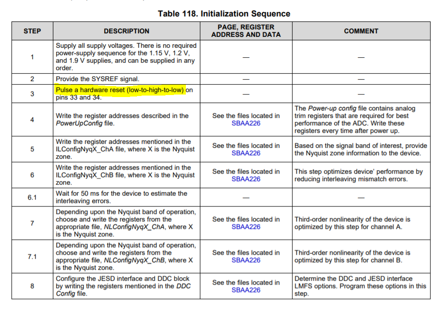

Hey team,
Quick question regarding the ADC32RF44, can a SPI reset be used instead of the hardware reset on startup?
AH
  • Hi AH,
    Hardware reset is required as shown in the initialization sequence in datasheet.
    Two corrections:
    Step 2 should be "Provide input clock and SYSREF signal"

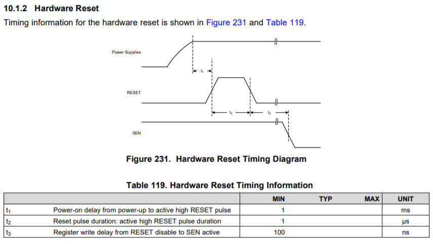

    Step 3 should be "Pulse hardware reset (low-to-high-to-low) on pin 48" (not pins 33 and 34)
    Hardware reset timing is specified in the datasheet  as below:
