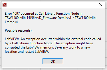

    What I'm seeing is if the VSG60 is connected, if I then open HSDC Pro it will now correctly populate the Connect Board dialog box with the TSW serial number, but the VSG60 will still disconnect( I hear USB disconnect sound when the dialog box opens, and again when I click OK). Often if the VSG60 is physically connected and I try to 'Connect to the Board' in HSDC Pro, the Select Board dialog box will open and quickly close and be followed by this error message. (I did see this a few times in v5.0 also but seems more often now)
    It is interesting to note that I do not see the same disconnect issue with the Signal Hound BB60C spectrum analyzer which also uses the Cypress FX3 driver. Where I was seeing the TSW serial number show up twice in v5.0 when connecting the BB60C, it now correctly shows up once in v5.1

  • Steve,
    We believe the issue is caused due to both TSW14J56RevD and Signal Hound shares the same VID and PID of the default FX3 device. Do not know if there is anything we can do to fix for this. We are still looking into it.

  • Steve,
    During the initialization process, HSDC Pro software tries to read the Device Name from the Non-TSW Board’s FX3 Firmware which is causing the “1097” Error mentioned by you. In order to avoid this error we should read the VID/PID values of the connected FX3 devices to differentiate the TSW  and Non-TSW boards, but we don’t have a setup to test and verify the same. In order to use the existing FX3 boards to test the above mentioned fix we have to enumerate them with different VID/PID which requires firmware changes. Building a new firmware for the same will take significant amount of time.
    Unfortunately, we currently do not have the manpower or budget to support building this new firmware.
    Jim
