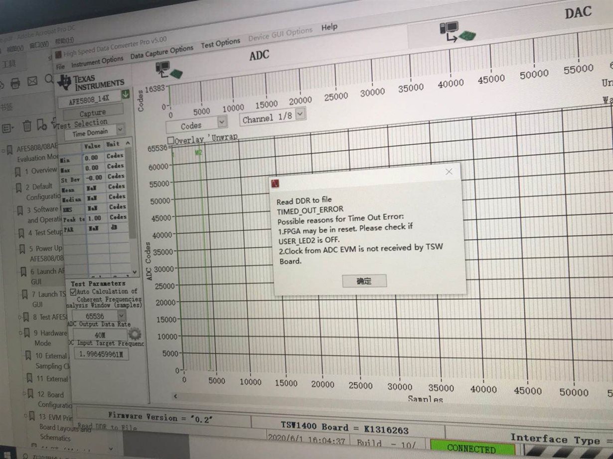

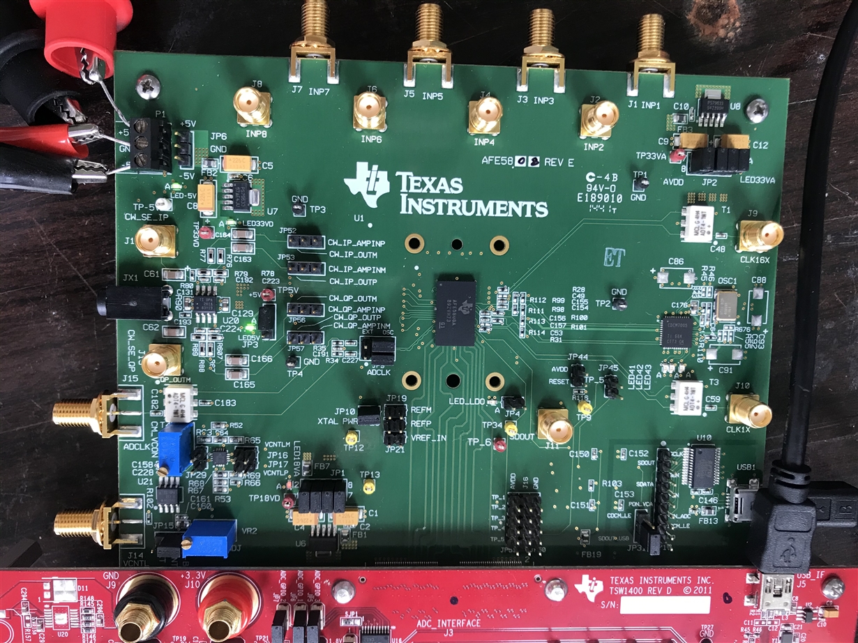

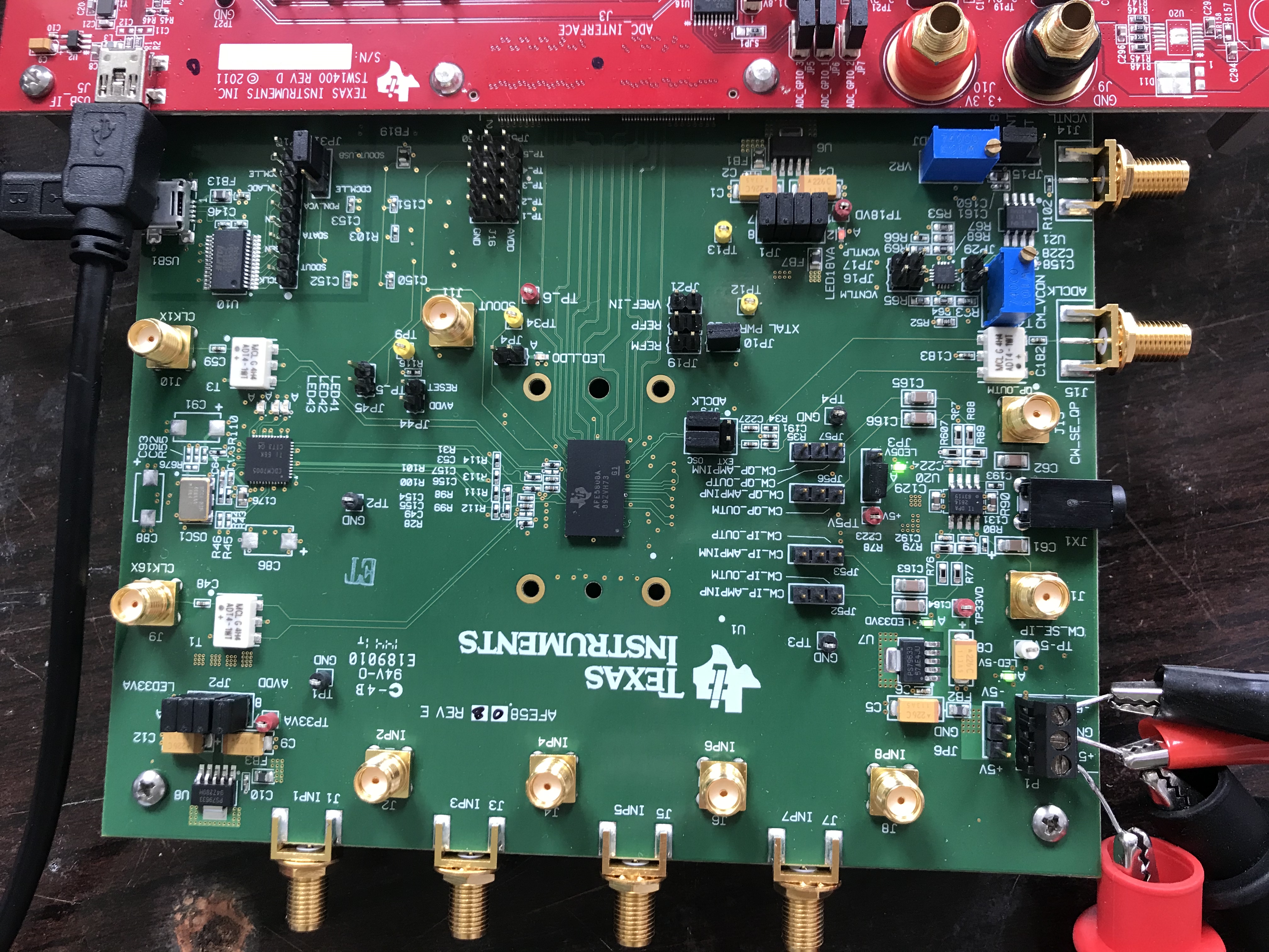

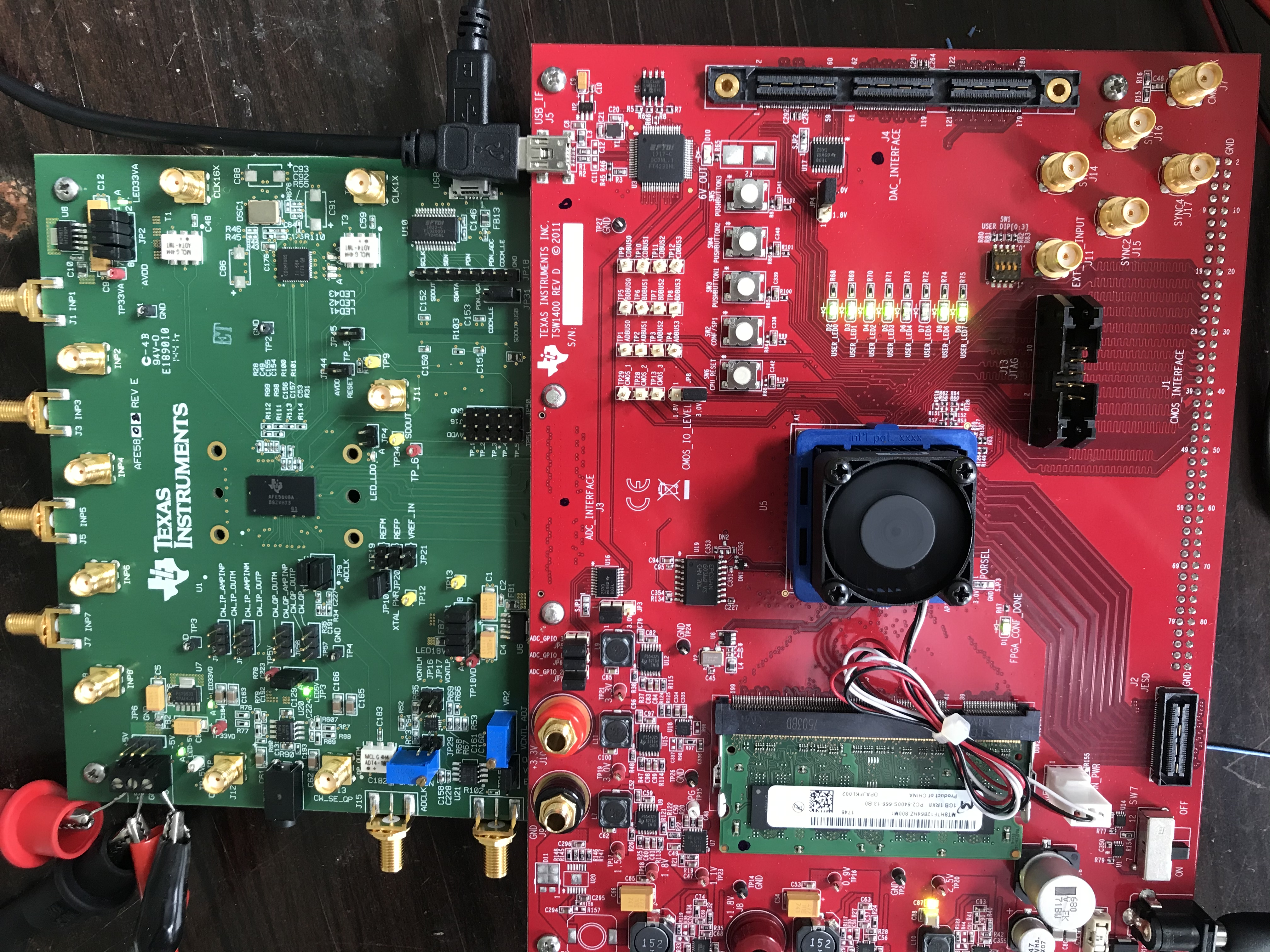

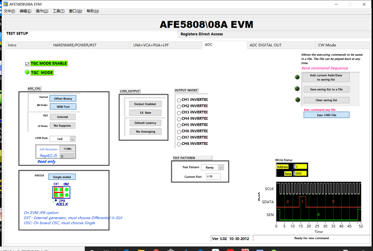

Customer encounter below connection issue at TSW1400EVM and AFE5808EVM.
Could you please give some suggestions?

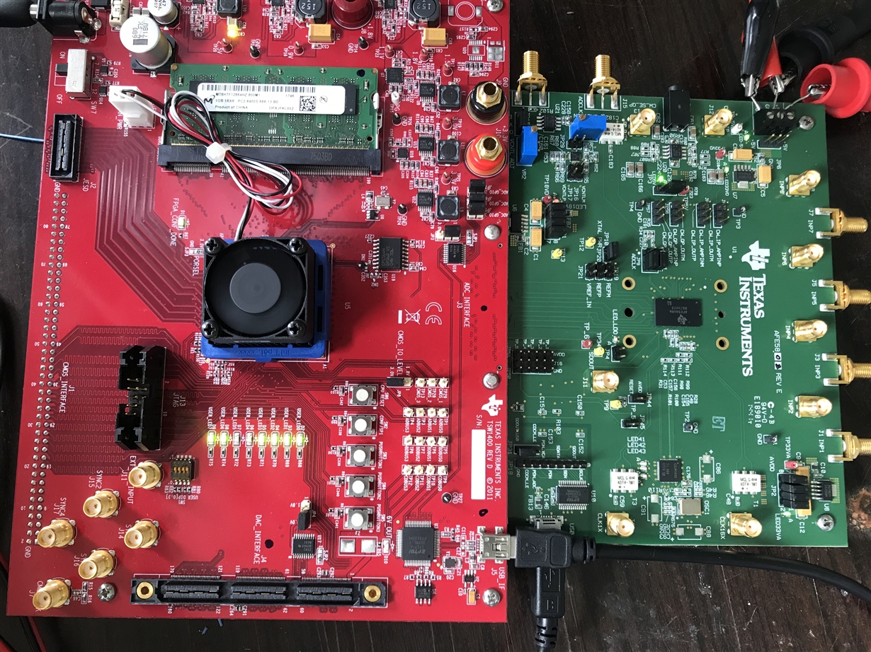

Thanks for using AFE5808A EVM and TSW1400 Board.
Could you please tell the customer
can they make sure the J3 (ADC_INTERFACE) connector for between TSW1400 board to AFE5808A EVM board
is connected firmly ?
Thank you!
