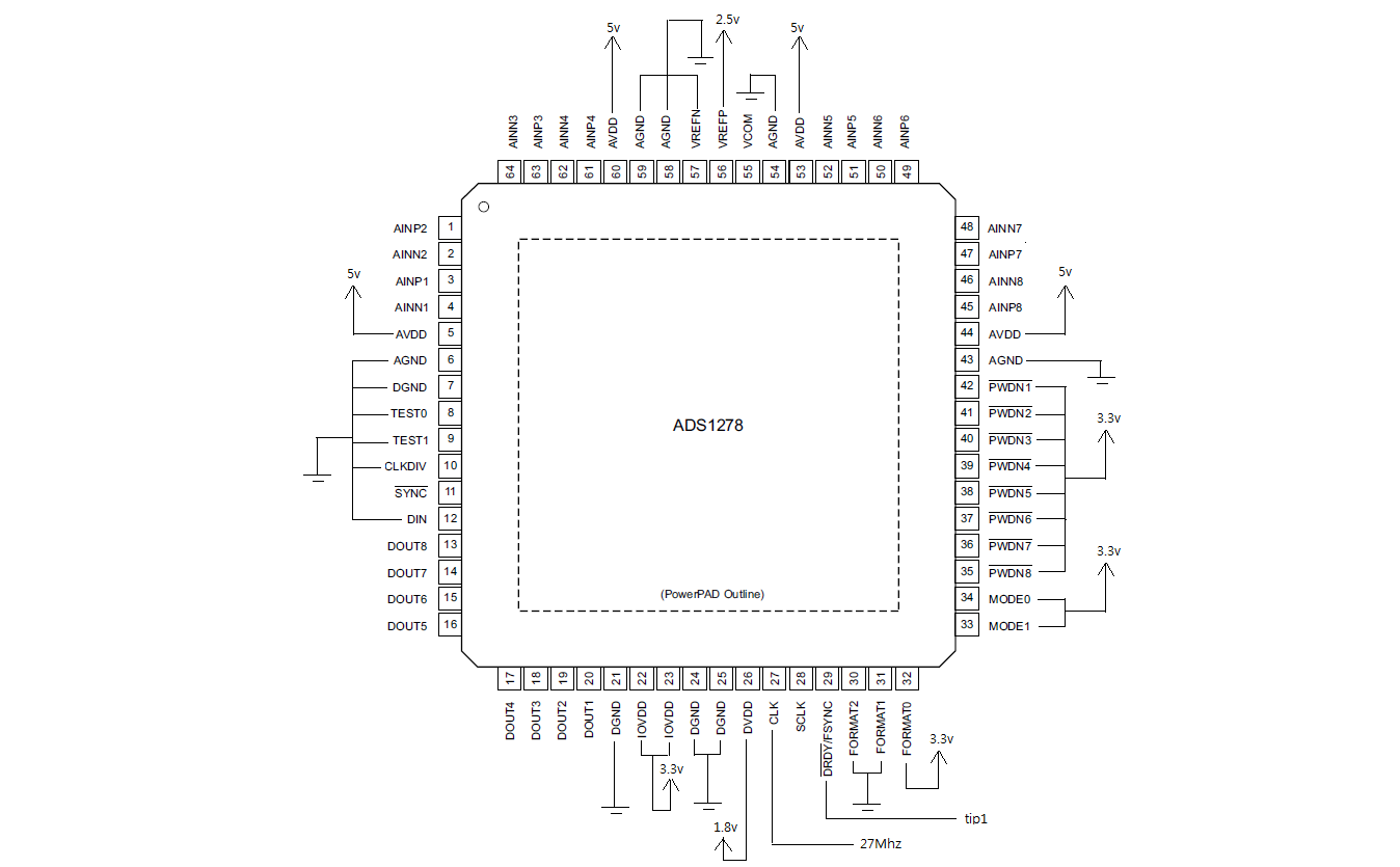

ADS1278: DRDY pin holds up during TDM fixed mode
Part Number: ADS1278
Dear
I attached ADS1278 schematic, and expecting pin29(DRDY) goes down periodically but it holds up
high all the time.
1. Do I have to input SCLK clock signal from a microcontroller to see the DRDY goes down?
2. I have not connected any AINN, AINP pins to anything. Does this affecting DRDY's output?
--configuration
MODE[1:0] : 11 low speed
FORMAT[2:0]: 001 TDM fixed
CLKDIV: 0 low speed
    It looks like you're in SPI/TDM/Fixed format of operation which it sounds like is desired.  If you're looking for a quick check on functionality then we'll recommend terminating some more of the currently floating inputs.  Connect the analog inputs to GND, /SYNC to +3.3V, and SCLK to GND.
    Also, since it's not shown, make sure you have proper decoupling on all power-supply pins as shown in the EVM User's Guide.
    If those things don't seem to change the results, try pulsing the /SYNC pin to see if it has any effect on DRDY.
  • Dear
    Thank you for your response. I have some questions:
    1.Connect the analog inputs to GND, /SYNC to +3.3V, and SCLK to GND.  <---- for SPI/TDM/Fixed
    format of operation should I always pull up SYNC pin to 3.3V?
    2."Connect the analog inputs to GND, /SYNC to +3.3V, and SCLK to GND." even after following
    this direction the DRDY pin stays high. So as you mentioned I start to pulsing SYNC pin and
    short duty pulses comes out of the DRDY pin. Does this mean that I need to initially input a few pulse into the SYNC pin for SPI/TDM/Fixed format of operation?
    1.)  Many applications use the /SYNC pin to trigger the beginning of conversions with an external event.  You had it floating, which is undesirable for a digital input so we requested that it be connected to a known potential (in this case +3.3V).  Recommended that you connect it to a GPIO on your MCU so you can use the /SYNC function.
    2.)  Thank you for the updates.  Pulsing /SYNC should not be required to start operation, however with SCLK tied low as we requested, the device is pulsing /DRDY which indicates it is waiting for you to read data as described in Figure 76. Try finishing the connections to the device and then try to read data.
